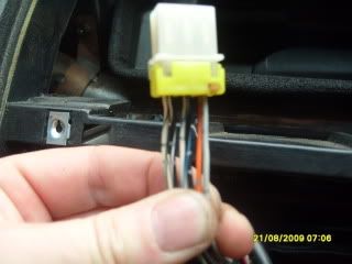

I'm trying to fit a new system to the Z. I've searched the site and found a wiring guide, http://www.300zx.co.uk/forums/showpost.php?p=1254445&postcount=11but what it lists as Z wiring does not match what is coming from the back of my original unit.
Some pics below of what is currently connected.

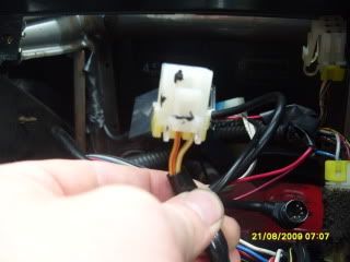

And this which is not connected

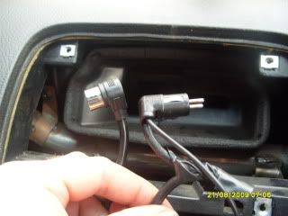

well the 3rd picture is the feed from the multichanger on the left and the aerial plug on the right

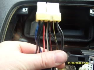

picture 2 is probably one set of speakers, the feed to the amp in the speaker unit and maybe a ground
picture 1 will probably be half the other set of speekers and half the power connections

not sure on 4th picture

Does anyone know if there is an adapter for that aerial plug, or do most people solder a new one on?
yes there is an adapter available, search ebay for nissan aerial adapter

ok, difficult to see the colours of your wires but:
on the 6 pin connector in picture 2 you have 4 wires that go to the rear speakers and 1 wire that feeds power to the amp units built into the front speakers if import and rear speakers if uk
asuming your conector as shown in the picture has the latch on the side facing away from the camera:
right hand side, cable furthest away from the camera is the switched +ve feed out of the stereo to the amps
right hand side nearest to the camera - not sure , only ever seen it on a unit with CD changer - might be switched power to the cd changer but thats a total guess {see ** below}
middle pair is one speaker - latch side +ve, non latch side -ve
left hand pair is other speaker- latch side +ve, non latch side -ve
on the 10 pin plug in picture 1:
the furthest right pair are front left speakers - latch side +ve, non latch side -ve
next pair are front right speakers - latch side +ve, non latch side -ve
centre pair: latch side is 12v constant from battery. non latch side is the feed to make the electric aerial go up
next pair: latch side is the feed from your illumination circuit, non latch side - no idea {see ** below}
left hand pair: latch side 12v feed from ignition circuit. non latch side - no idea.
it is possible that one of the "no idea ones" may be a ground (0v) however generally the 300zx did not have a 0volt feed in the wiring loom but instead had a seperate wire that ran from a crimp on the bulkhead behind the stereo to a bolt on the back of the stereo. therefore when fitting aftermarket stereos you generally need to either bolt this 0volt wire to the new stereo or splice it into the new stereo loom where it expects it
alternativly you can just buy a nissan to ISO adapter and splice in the ground and power amp feed if necesary

** looking at the picture in your rides, your stock stereo looks the same model as one i have here. in this case these 2 pins are not fitted to my stereo, however the car it came from does have a grey wire in the loom that went to the non existent pin in photo 2. presumably they are therefore cables in the loom incase the origonal buyer decided to upgradee to a better stock stereo. in this case you could probably ignore them

do you mean with the actual aerial as in the 2 pin plug in photo 3 or the power feed to make the aerial go up?
