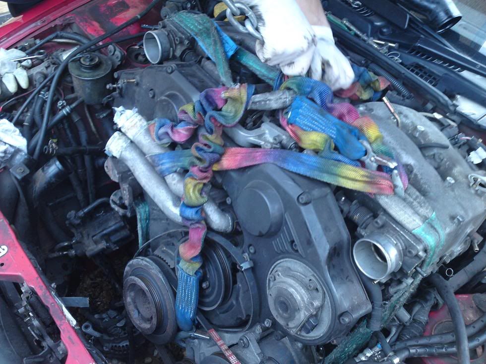

Finally got round to dragging the engine out of the red zed today to get the drivers side turbo replaced. Came out easy enough but don't see how you lot can do it in an hour or two :confused: Turbo was well and truly seized, wasn't oil starvation and certainly wasnt bearing collapse. What usually causes them to fail?
Check out the Technicolour Dream Rope © :rofl:

Good work bud.once youve done a few its not bad at all and can be done remarkably quick.Did you leave the a/c compressor on the engine? You can leave it behind like the power steering pump.Be 100% sure the oil line is good as tubs dont seize for no reason.
Yeah left the a/c pump on whilst we lifted it out, but its coming off tomorrow as I'll be doing away with the a/c. The oil line certainly seemed ok from a visual inspection, we had a good poke aroung to make sure there was nothing obvious :)
