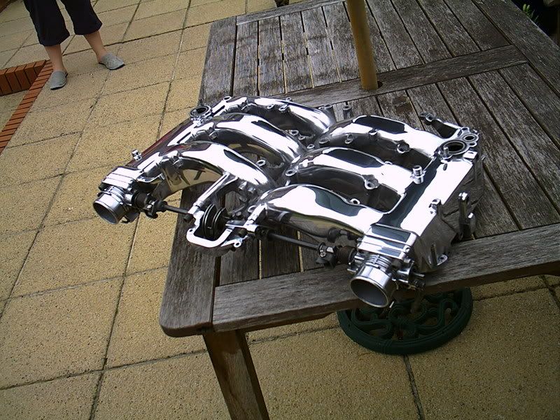

Well, I am about 10 hours into the polish now and that's the initial prep done - doing the grinding and shaping required to remove the castings and other unattractive features.
My plenum casting was not very impressive to say the least - very pitted.
And I have moved a lot of metal to get to where I am now.
I estimate about another 8-10 hours at 120/200 grit wet and dry (hand and mouse) and then maybe 8-10 hours with the polishing wheels. So 30ish hours total.
I am not going any parts that will not be seen - life is too short. :nono:
I completed the balance bar in about 3 hours total - pics later.
TOOLS: Most useful has been the Power File, but also the mouse, various size and shapes of wire wheel used in a drill, various files, Dremel, angle grinder and a 3" and a 5" sanding disk for the initial 60 or 80 grit work.
COST: Consummables so far - £14.00 on velcro disks, £12.00 on Power file bands and about £10.00 on Mouse pads. Plus £20.00 on Dremel bits and about £20.00 on polishing kit/abrasive blocks etc.
Hope that inspires someone to go for it themselves - will post some final pics when done.

Looking good bud , I,ve done a couple , it is a dirty and time consuming job , but worth it IMO :hyper:
Wow - That's what I aspire to - but I am almost sure that mine will NOT be as good as that. That's a brilliant job. Well done - respect. Wanna swap ;-))

Thanks all for the kind comments about my polishing job , i used different grades of discs on a D.A sander , starting with 80 grit , 120 grit, 180 grit and finally 320 grit before going at it with a polishing kit .Also used a small belt sander and a Dremel to get into the nooks and crannys , alot of work but worth it :D:D.

Well I thought I would try out my new toy as above - and I got from the standard (straight off the engine) dull grey look to this in 40 mins - that's about 20 mins each with a brown mop and a white mop - nothing in between, no sand paper, wire wheel. Can't see in the picture very well but I can see my ugly mug in the reflection pretty good.
Probably not good enough - but closer than I expected. The right tools sure do help!!

Get your self some dremel emry wheels and then some felt polishing wheels and finally some cloth polising wheels with usual brown and blue bars and you will be able to get in between the ridges on the throttle boddies. It looks really good if you can get in there (not that I'm obsessed or anything!!)
