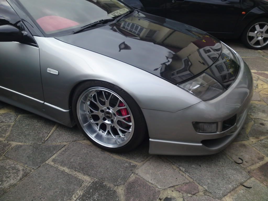

Ok, my turn. I started the whole 'stance' thing off on here as I am a stickler for decent fitment/stance! LOL. Whilst mine aren't as extreme as yours (although my tyres are wider), they are almost the max at which stock unrolled arches will allow with those tyre sizes too. Mine is also running on Tein S-tech which are about 20 - 30mm lower than stock ride height.
My fronts are 8.5" wide. With an effective offset of +20. 245 40 18 tyres
My rears are 9.5" wide. Offset is running at a +35. 275 35 18 tyres
Thanks Si looks good, nice flat tyre side walls and almost perfectly flush.
Yup, it was what I was aiming for. Since I wasn't rolling my arches, I had to go flat tyre walls over mild stretch. Stretch looks good on very low cars with aggressive offsets (tucked). My springs have settled a bit, so might get the camber re-checked again soon.

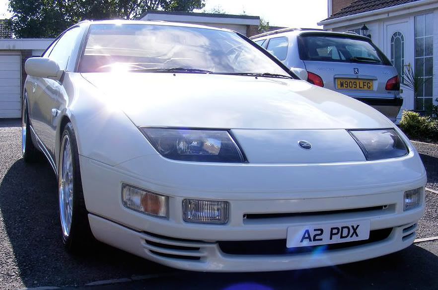

radius r6 alloys, 235,40,18s all round no modifications, sorry have'nt checked the offset
245,40,18s i have also used with no problem a little tight at the front spring bottom platform though.

cheers matey they are radius R6 alloy wheels had them a while now, really pleased with them
Really need to know more Dave/FASTEREDZED for it to be worthwhile as you've left out the 2 most crucial bits of information. ;) Wheel width and offset.

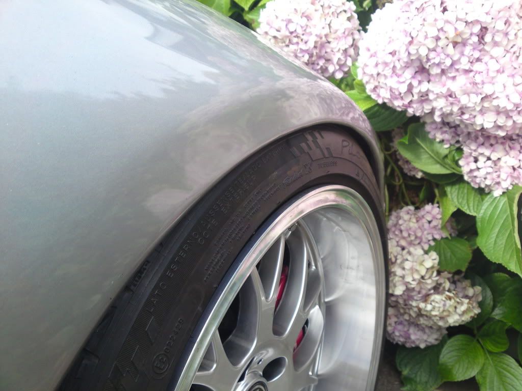

but... this is the outcome...
mine looks like that when you jack it up but then as you lower it, it tucks in.
That should fit with a tiny bit of lowering and maybe a touch of -camber.

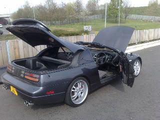

Mine as Tenso 18's. Not sure on the width of the rim itself.
Front:
245/40/18 - unknown offset
Rear:
275/35/18 - et35 i believe.
Car is lowered by an unknown amount. Standard arches and I get a tiny bit of rubbing on the rear through severe dips in the road.

Going to get the arches flared and rolled to hide the wheels a bit. the car is sitting pretty low on coilovers. that pic may of been when it was on the car lift. not sure as i didnt take it.
