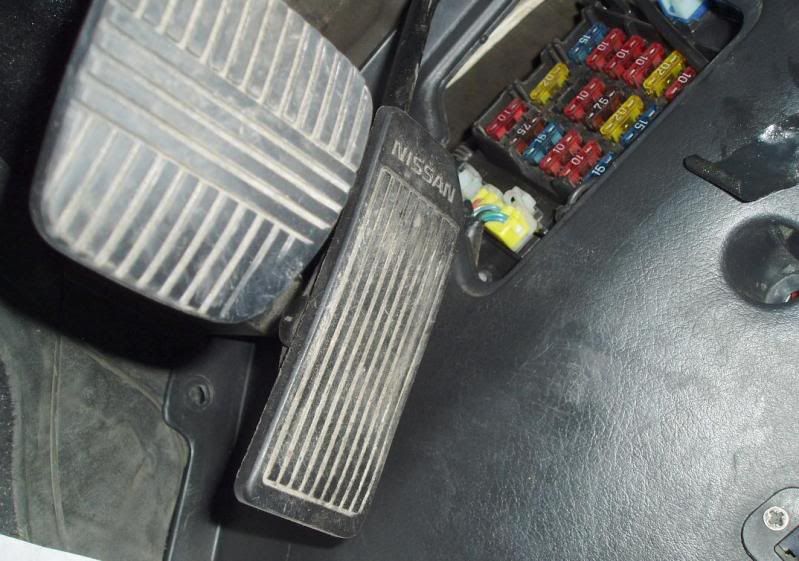

Photo A Shows the pedal assembly at rest

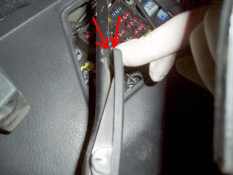

Photo 1 Shows the pedal edge on, you can see the gap between the pedal top and the operating arm.

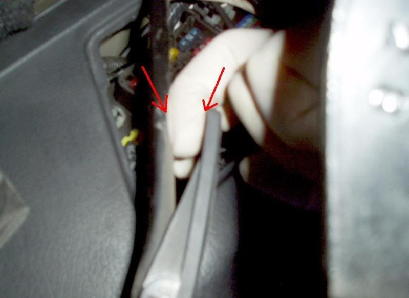

Photo 2 Shows the pedal gap now closed
This gap is set by the a small spring assembly behind the pedal itself, assumedly this was Nissan's way of keeping the pedal angle set through it travel as you press it down, however it really does not seem to be that effective but what it does do is give a dead feel at the top of the movement, this can be more or less noticeable with different shoe's / trainers / shoe size but with auto boxes especially it can seem like the box is unresponsive in certain situations when actually its the pedal which is unresponsive.
So the gap needs eliminating by clamping the pedal assembly to remove the excess movement, finding a way to do this is dependant upon what you prefer the top of the pedal angled back or the bottom of the pedal angled up either way this can be done by fixing a small piece of packing between the pedal and operating arm.
Remember this will not increase power what its does it take the flex out of the accelerator movement, which in turn can give a more responsive feel not just at initial pull away but when cruising on a light throttle and then speeding up.
