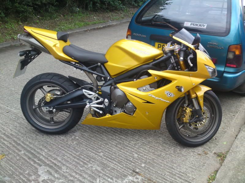

bro in laws new bike
a 56 plate triumph daytona, he has a question though
first quick pic of the bike, tis immaculate, few bits missing like rear seat and bolts for pegs

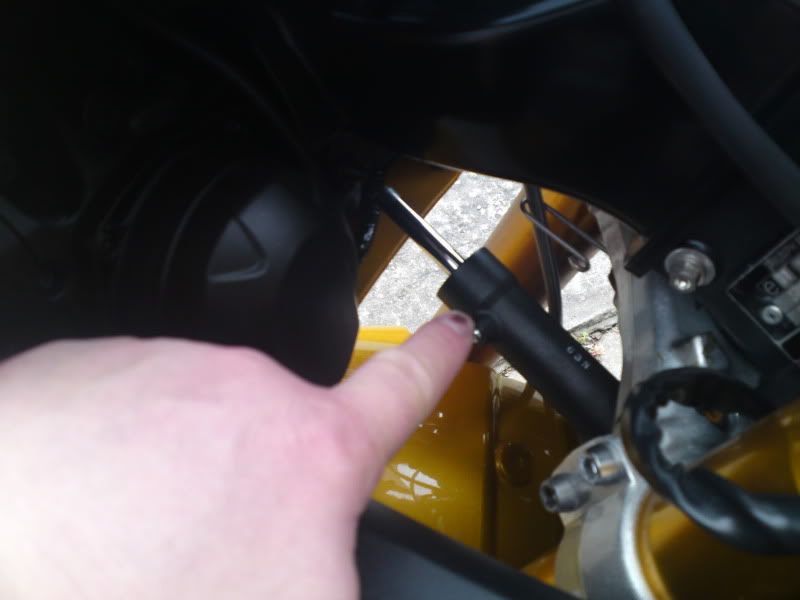

now the prob, he has noticed a shocker type jobbie behind the front fairings that seems to have come off from somewhere, anyone know what it is
Its a steering damper. Which end isn't attached. the picture is crap Al and have you got a black nail? Should be attached to the forks somewhere and then to the frame.
tis attached to the frame but isnt attached to the forks, where will it go, he thought it was a type of steering dampner, my black nail is from hitting it with a hamer accidentally lol

Sold em for a few years but before this model. Where the damper attaches to the forks should be pretty obvious will just bolt in. Bolts for the rear footpegs will be easy any hardware gaff. If I was him I would get the thread etc and get stainless though.
