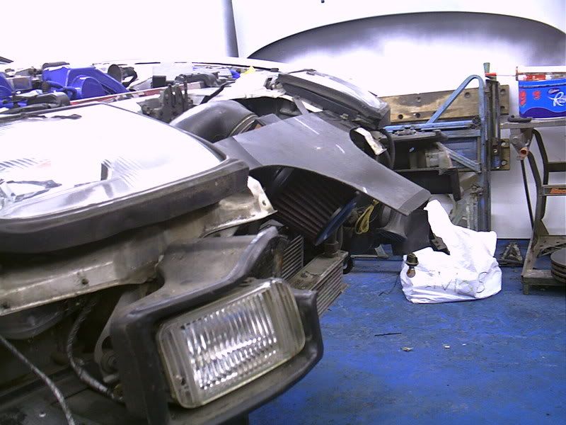

This is a cover i made for my filter , i know it looks like a pair of pants but works a treat:rofl: , made out of stiff plastic .
Cheers mate but I have had a new wiring loom and new temp sender, I did make a perspex cover to go over the filter but it caused my nose panel to sit higher than my headlights and looked daft + it still hesitated anyway, I think my MAF might be on its way out but it funs perfectly fine after 10 mins or so. Seems to only happen when cold.
