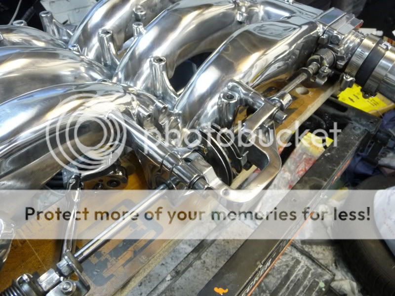

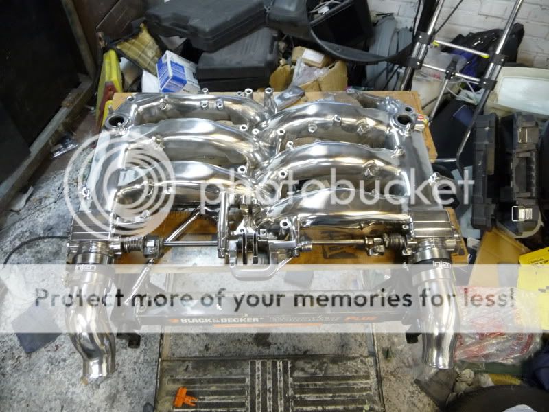

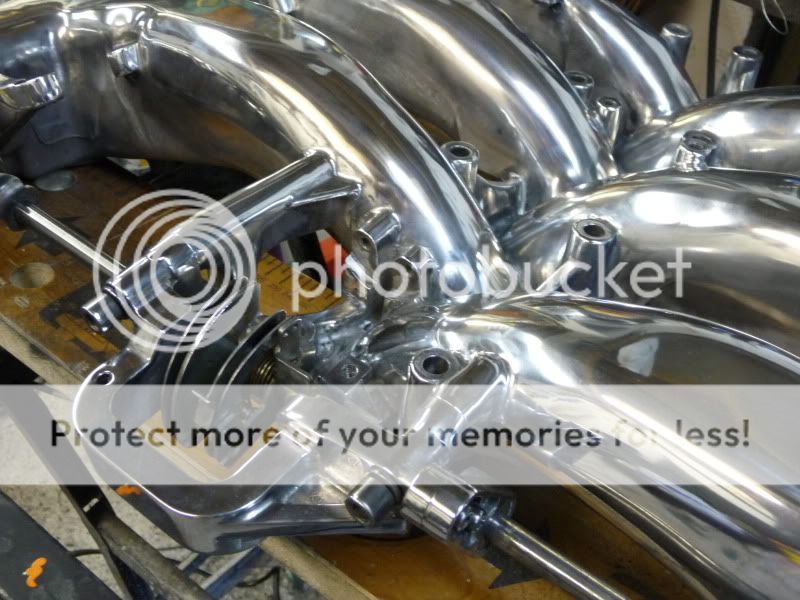

About 3 months ago idecided to get my plenum off and and replace it with a half finished one I bought from Bantambunny.
The idea being to accentuate the curves in the middle of the plenum and have them exposed by removing the throttle cable cover, re-routing the Coil pack wires under the plenum and re-routing the injector wires under the plenum.
However it didn't end there!! I then decided to remove the castings that accomodate the bolts for the throttle cable covers!!
After putting it on the block to see how it looked I then decided that it needed more polishing as the lack of wires exposed even more of the plenum!!!
Anyway it is now finished and I will get some final pics up soon but for now, here are some half finished ones!!
Andy

I know elbo grease is one thing needed, but how did you get it that way.......Its brilliant
Cheers Sonic.
Drill, Dremel, Sand paper, Emery cloth, more remel with sanding attachments, sanding sponges, Cutting paste, Pollising mops (hard and then soft), AutoSol and Finally, brilliant polish!!!!!!
