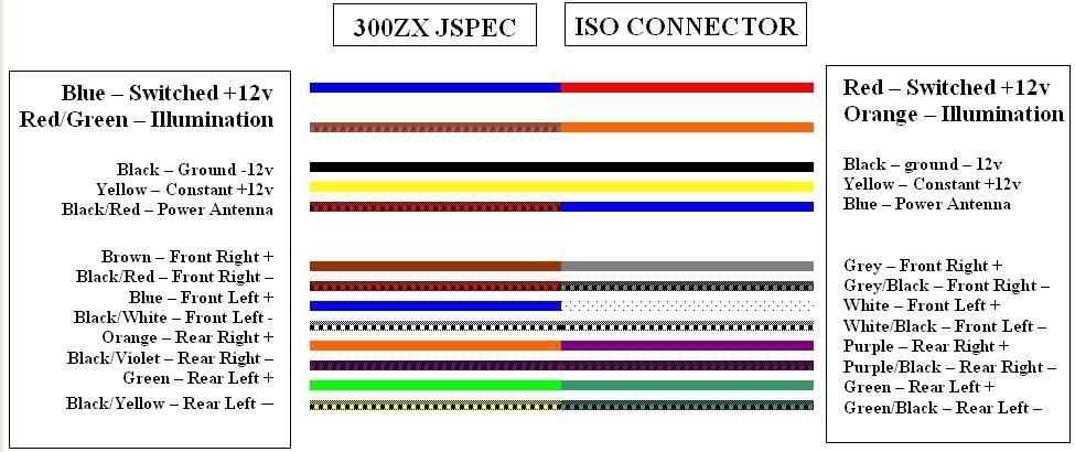

Don't know if this will be of any use to you, but worth a check though. Attached is the Radio wiring for the UK and JSpec cars (although the UK colour coding is for an adaptor loom and not the car side, I must try and rectify that)
Any probs with the colour codes, post up and I'll see what I can do :D

thnx dave and all others for your help, ill try snipping the wires now and doing it by colour code
