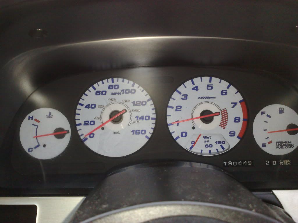

Hi guys ive just got uk speedo for my car,now the prob i had with my last ones was that the speedo was about 20% out.pic of last clocks 13122008105.jpg
Now ive put the uk ones in the speedo is way to fast,does this mean that my car is running in kilom and not mph,if so how do you sort this,plus any pics of wot to sort.:confused::confused::bow:

Don't help that your clocks only go up to 160 mate, it should read 180 and some have another line after that indicating 190.
So and without checking another set of UK clocks, i would expect a reading of 140 on those is really 110 on standard clocks.

he has US dials on those! If you have UK clocks, you will need to get UK dials for it to be calibrated properly. Problem is UK dials will have the cut out for the bosst gauge as there were no UK na's.

They are not UK Clocks ! They are Import KPH clocks that somebody has stuck a MPH sticker on.
They are reading in KPH.

If you wanted to get them reading correcting then you need a KPH>MPH convertor. Nothing wrong with using these clocks if you get a converter.

I have Jap clocks with the mph sticker over the top. The convertor is really easy to wire in. Not sure where you can get them from though. Its just a matter of clipping a few wires behind the dash then wiring a small black box in place, all the wires are labeled/colour coded.
EDIT: Plus the grey wire which is supposed to go from the convertor to the ECU has been clipped off on mine, so the ECU reading goes straight from my Speed Sensor from what i can gather.
