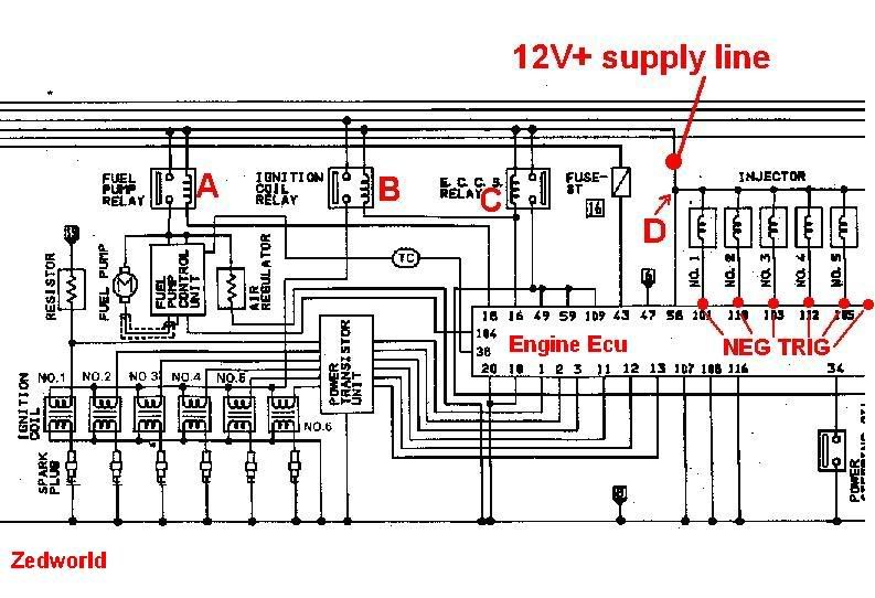

cars been down garage, and theyv had RAC diagnostic thing onit aswell.
the injectors are not working, not clicking, and not getting power/earth.
ive done a NA to TT conversion, kept the NA loom. using the TT ECU
ive changed the connections on the front 4 injectors.
the ECU is not showing any error codes.
the injectors were working fine before i did the swap, as the engine is from my old car, as is the ECU.
do i need a new loom? im about to give up on the car :(
