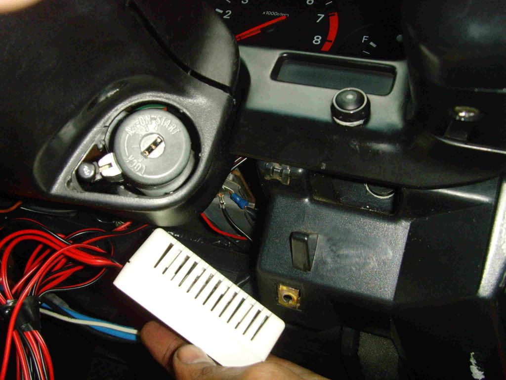

Hi Guys, I have found a small rectangular electronic box under the steering wheel behind the panel above your knees.
I have unplugged it and there is no apparent difference with anything and I'm just wondering what it is and its purpose?
It seems to be OEM. My car is a Jspec auto TT (93), I thought it might be traffic related?

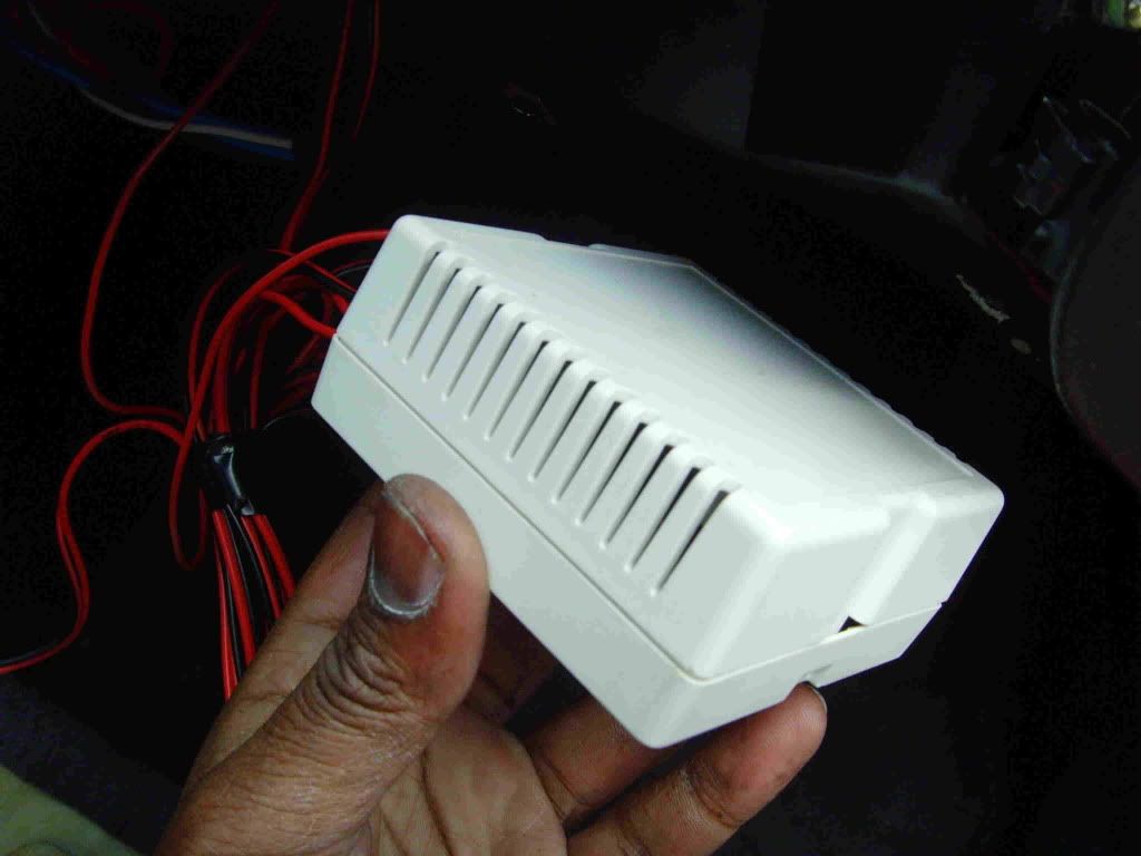

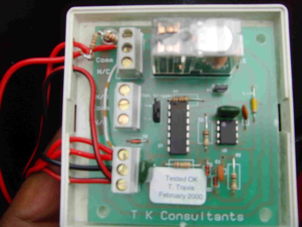

I had a small box in a similar position which I removed. Never did find out what it was but it was unconnected so removed it without any apparent ill effect. Here's a pic of mine...
Jus t Googled TK consultants, it looks like its a relay timmer so an alarm can be set with a turbo timer fitted.
Aha...interesting. Cheers bud. Don't have a TTimer anyways but maybe look into it when I get one.
