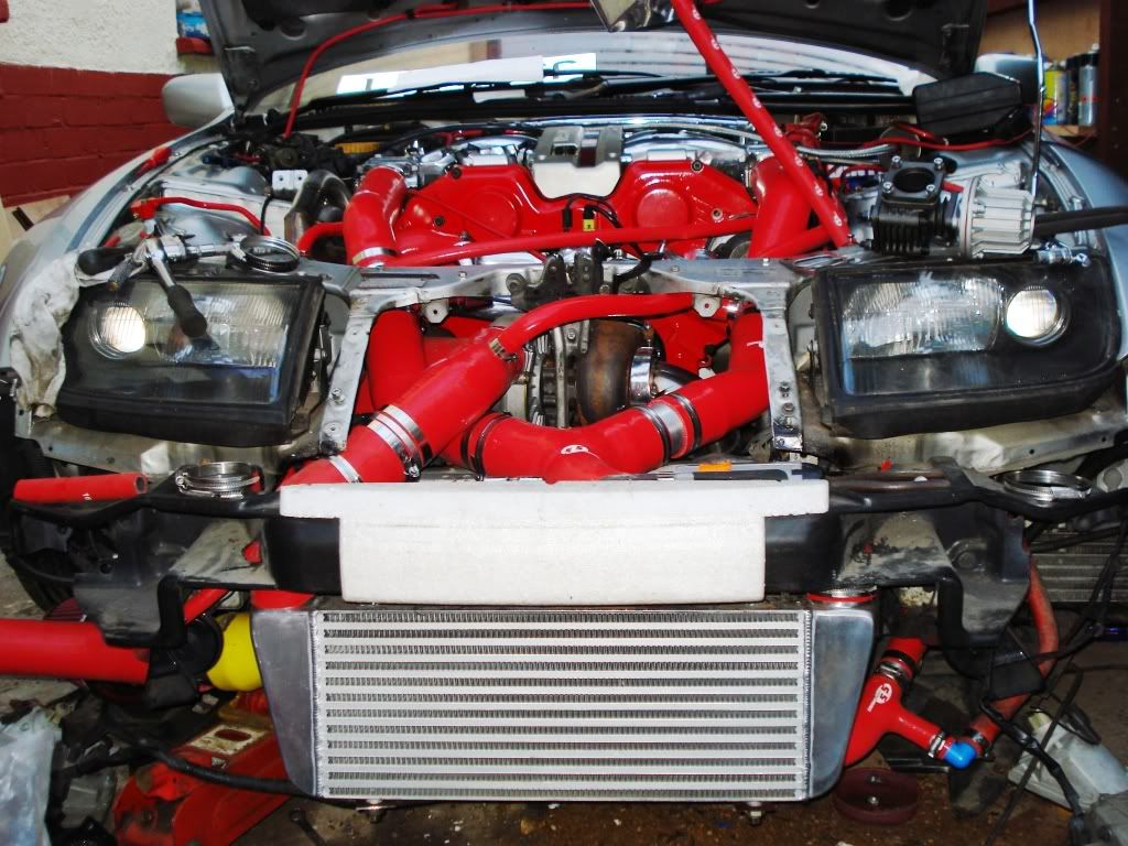

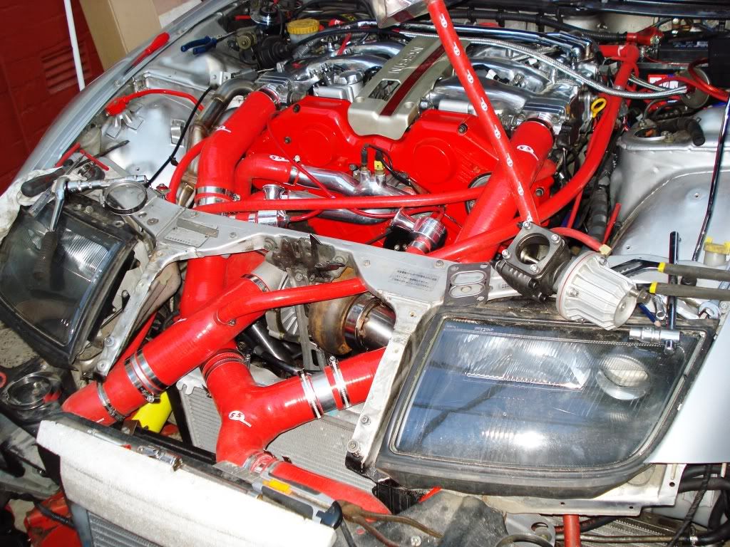

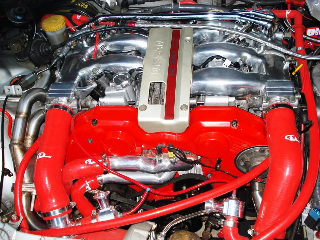

Cheers Stella for that, I've got the bit between my teeth now and can't wait to get her on the road. A few more pics to wet the appetite!
Tomorrow is finish the MAF intake, bleed the coolant system and clutch, get conzult on to do basic set up, then out of the garage for a wash and maybe some pictures. The only other job is is to joinn the turbo outlet to the exhaust centre section and back boxes.
looks a bit compleczted, but is probably easier to work on now lol
top work fella, maybe take the zed to new levels????
In a small picture it does look a nightmare but in th eflesh it's not so bad. Honest!
my god, where the hells the radiator? looks easy to work on tho/ less heat soak around the sides but i guess the lack of front cooling will compensate :(
Keep an eye on the water temp.
Jimmy, it has 2 smaller rads in the nose behind the intercooler. I am fittning a slimline push/pull fan inbetween them. I'll see how I go with that but I think I have enough room to fit a secong one if needed.
