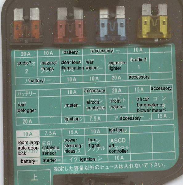

If the audio fuse in the footwell has blown it will cause the door open light to stay on.
