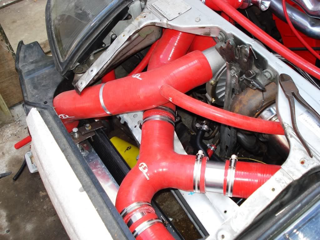

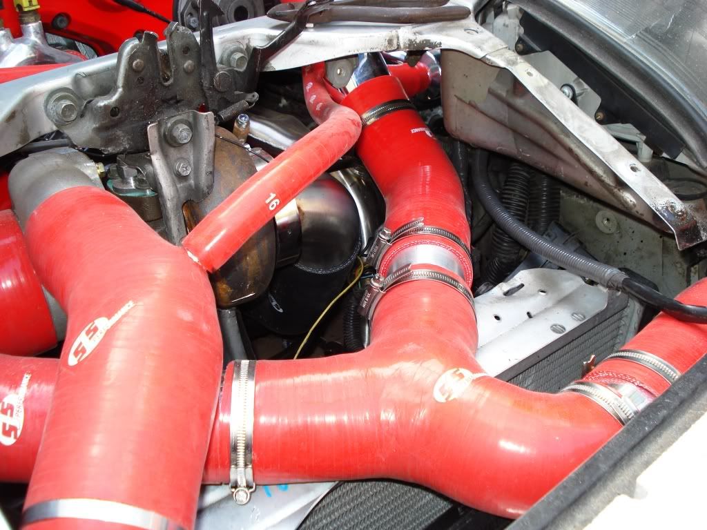

Just a few pictures of progress, the pipe work for the turbo to intercooler to throttle bodies is done as is the cooling system pipe work for the two radiators. Just the radiator fan and air inlets and turbo downpipe to go!

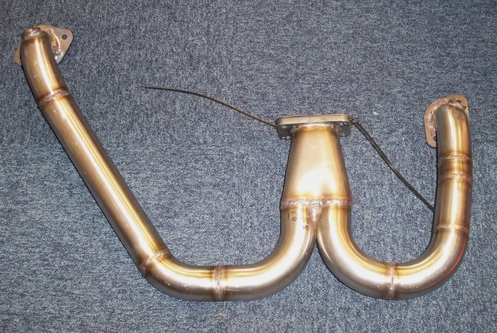

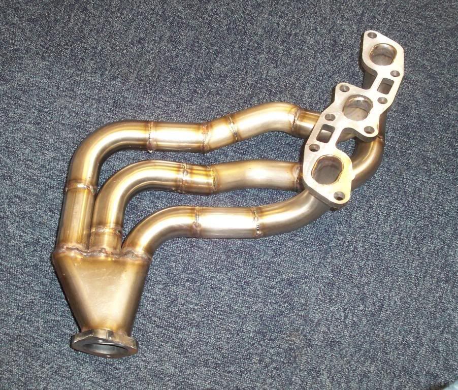

Have you got any pic of the headers...I have curiosity with the exhaust job...

ufff, impresive....and the exhaust working will be the hell!!!
Thanks for the pics

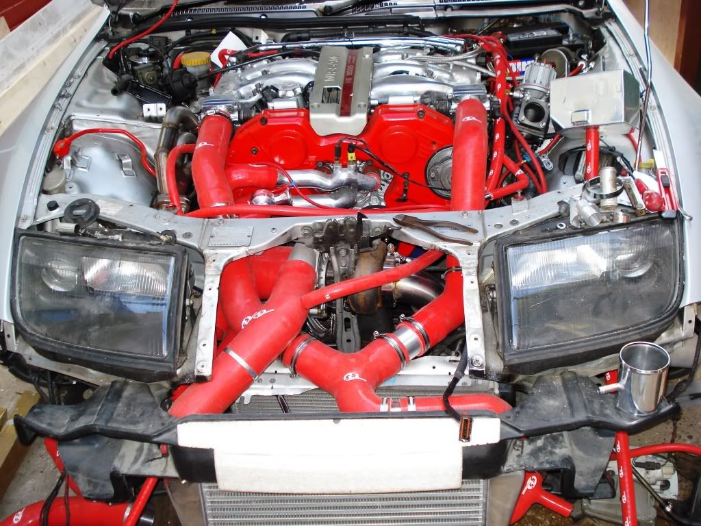

Looking good, have you got it started now? I think the last thread I read you were having problems starting it? Was it the ECU?
guauuu, very thanks for the pics...
Really, It is a good idea to change the turbo unless remove engine...jeje
How many horsepower will you want aprox?.
Good job!
Haven't had much time (trying to sell the house so been knocking down an old garage and finishing the new one) so not started yet! I have narrowed it down to no spark. Also ruled out PTU and CAS so think it is the power supply to the ignition. So this weekend will be going through the fuse box loom as I now have time. Hopefully some news very soon!!
Good job!
Going for 500bhp+ If the turbo can't cope it'll be easy to change ...
Anthonyh each time i see your threads i check them out, still looking good, but i truly admire you, something differnt from the norm.
Keep em coming.
