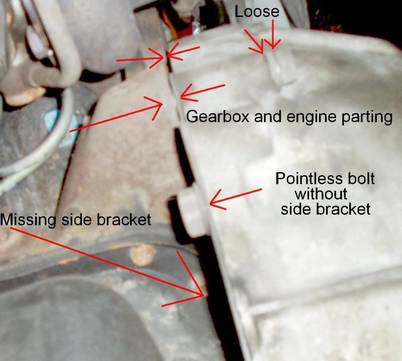

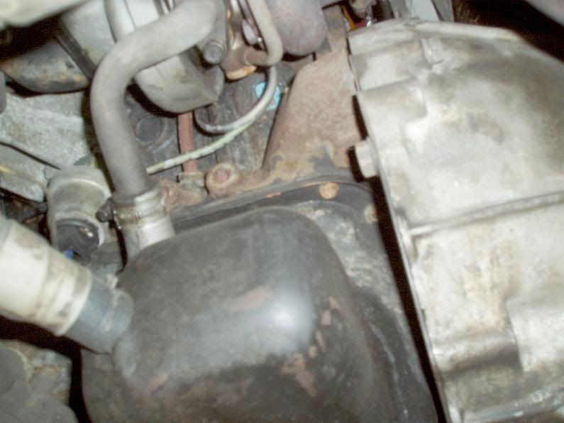

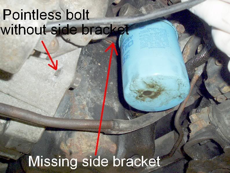

Ok what we got here then, a zed with an odd sound from the engine area, some thought was big ends, some thought was little ends and some even thought VVT springs.
Well non of the above, the car has just been treated to a pair of new turbo`s ( last month) but they are fine and fitted well and are not the problem, sadly cannot say the same about the workmanship on fitting the gearbox back to the engine

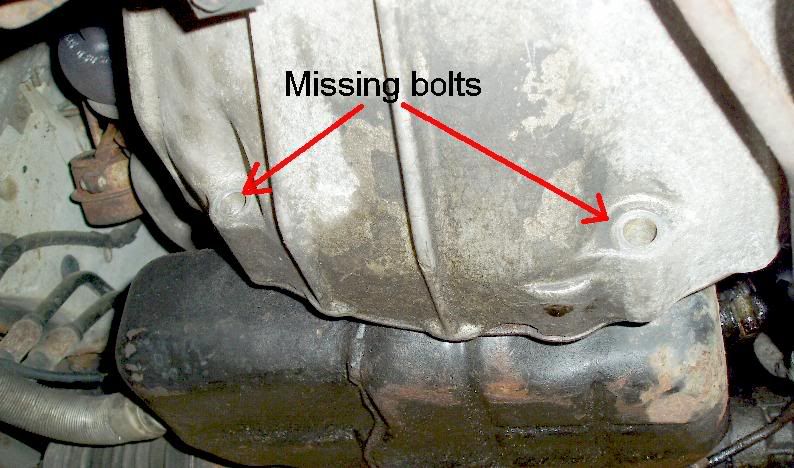

Cut it short when the gearbox was refitted he did not refit the side brackets between the gearbox and engine so there was no lower fixings at all, the top 4 fixings were all loose and the gearbox had started to fall backwards!!! the flex plate was been twisted by the torque converter !!
New side brackets 6 new bolts and all the others torqued up and all was well...lucky man.
Oh and where had it been done....well I am dumbfounded to say by someone who professes to be a 300zx specialist and is known here, this is shocking in our view and I sincerely hope the customer complains about this shoddy work.

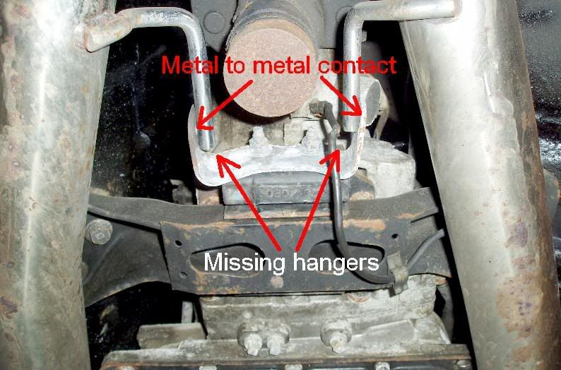

As a side issue , the last photo shows the exhaust brackets missing on the gearbox, but even worse the hangers were jammed solid metal to metal which would cause noise and vibration.

Steve your a mind reader:D when originally posting this thread I did it for information only hence no requirement to include names etc. I have since had the opportunity to speak with the both parties again and it transpires that such things as the side brackets were in fact already missing and the loose bolts had been torqued up, speculating why they subsequently came loose etc. will send us all crazy so as Steve correctly said lessons learnt all round.
