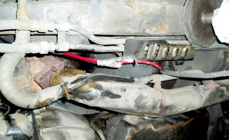

Unbelievable what you find when changing an auto box today, given a previous thread about dangerous cable instillation was just a week ago to come across and almost identical case is bizarre.

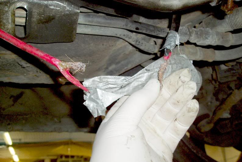

The second picture shows the cable wrapped in grey duct tape, when this tape was removed the cable was broken and just twisted together!

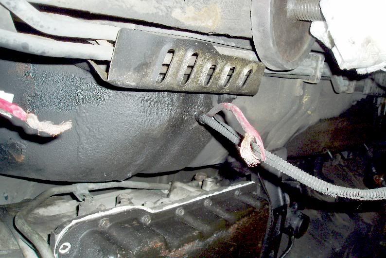

The cable ran up alongside the passenger turbo, and the cable insulation was blistered along its length past the turbo.
