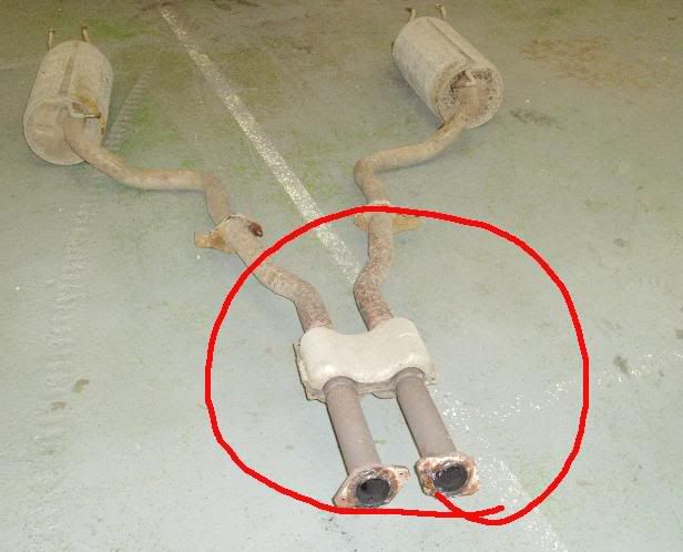

Ok if you have one of these fitted under your import zed then you very likely to still have the pipe restricters welded in.

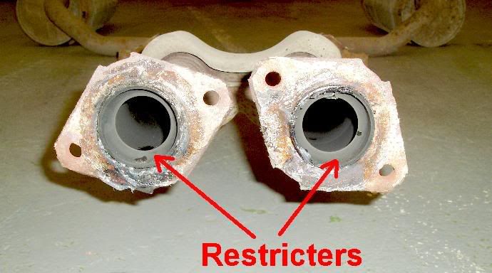

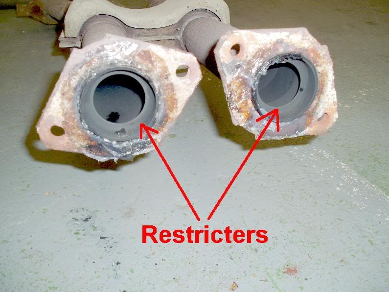

Here is what the restricters look like with the exhaust removed,

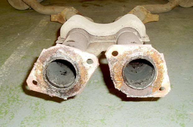

Removal is easy, a hammer and chisel and it soon looks like this.
Why are they fitted originally, is it emissions?
It was standard on Japanese imports, they had some kind of agreed BHP figure there and its to keep within it, I am sure this is why lower powers are talked about for imports.

Blimey, looks like something hauled from the wreck of the Titanic!
i noticed that wheres it been parked? the north sea?
Came for a zed that is parked sea front on the west coast, you should have seen the rest of it!

What's the purpose of the bit in the centre of the circle in the first pic? Are the two sides of the exhaust joined?
