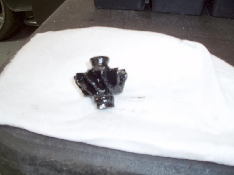

Now this was a surprise:shock: poor owner thought he had a loose cat shield or similar, this fell out of the n/s cat when we undone it to check out the turbo.

excuse my daftness but what is it for? Where would it normally go on a car?
It is the exhaust turbine from the turbo!!! the shaft had sheared.
Jeff TT
Holy Crap!! iv seen one that had been shot out the back of the exhaust but not 1 stuck in it! Thats insane!!Poor guy!
and i thought mine was special saturday jeff loosing boost through the sump:shock: no thats gotta be a bummer...!
Which tubs did it sheer from Jeff?
Standard one, passenger side was smokiiiiiiiiiiing
Jeff
how the hell did that break off like that.... lol
Goodness knows, seen a couple of turbo`s in the past which have sheared the shaft, can only speculate........ balance, vibration, metal fatigue or all of them.
