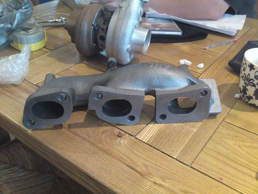

ebay ones yes. do they look it from the pics. i was gunna bring them along to a meet for peeps to have a look at.

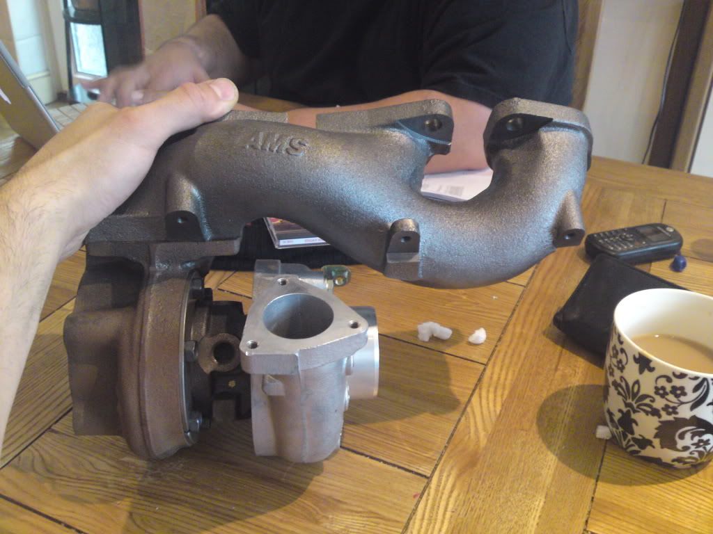

yes would be a good oportunity to put them together, I think it was topless who said someone had the ams, ebay, and mike smiths back to back, they couldnt tell the difference between the ams and ebay ones, although the mike smiths were smoother inside which is expected.

take a pic of those manifolds, lets do a comparison.
coz im on a bidget it was either ebay jobs or stock manifolds. Im sure id be happy with the power with stock turbos, this is just a bonus, wheather they flow well or not is risk im willing to take, if they are close copies of ams ones then they must make a difference over stock.
yeh. I told topless about them. It was'nt actually me that seen them side by side, it was paul@swz, so as I said to him and others Im only going off what Paul told me.

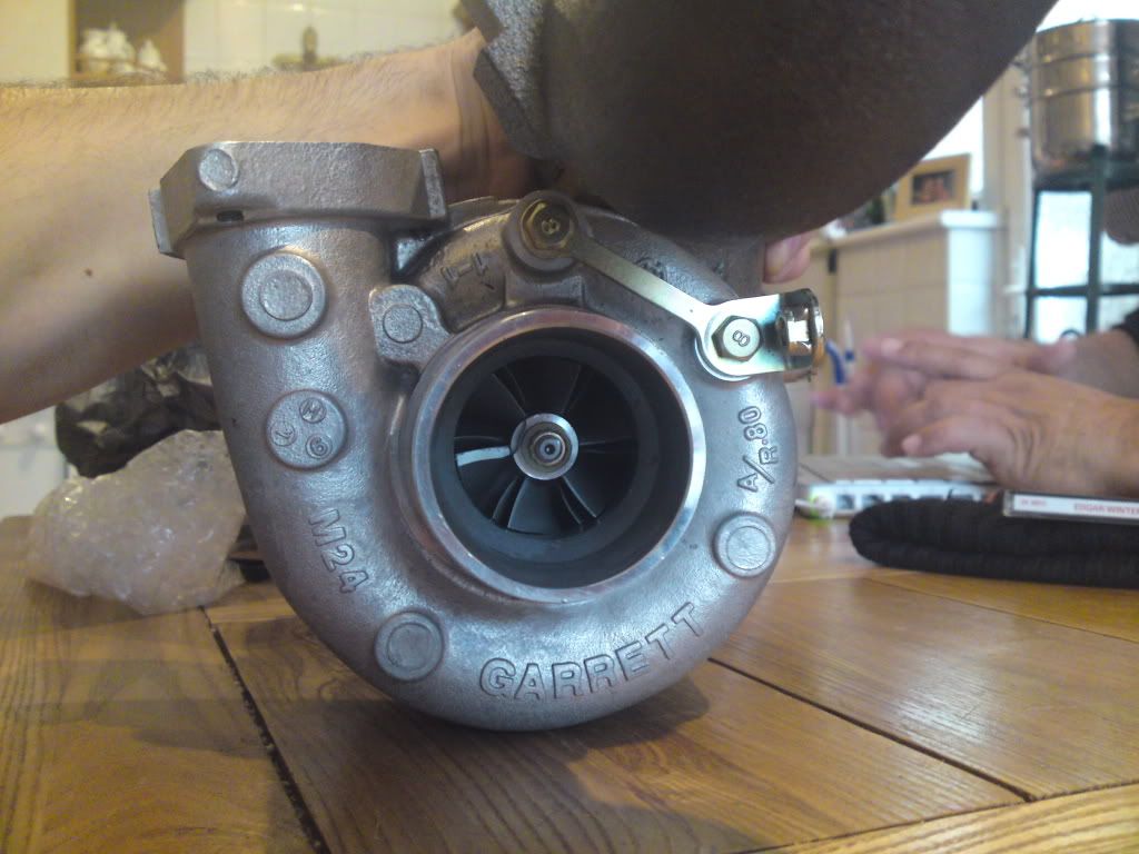

As far as I know they were test fitted to the engine, but not actually bolted up tight. I seem to recall the turbos needed to be twisted (circlip released on the turbo and one half spun around) so that the actuators cleared.

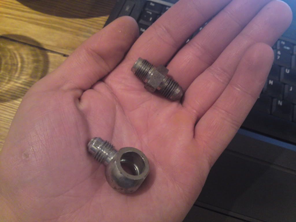

These are the bits missing simon:
one more restrictor and one banjo.
EDIT i dont think i need more than one banjo bolt, but i still need the other restrictor, if you havent got one then il have to buy one but im not sure on the thread sizes, i know it has to be a .035 restriction tho.
Also if anyone knows where i can purchase the oil return gaskets this would be helpful

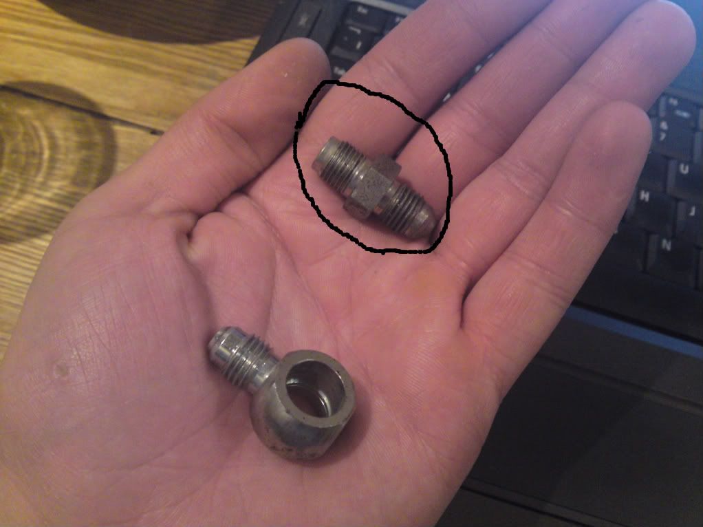

I have all the oil feed lines, thats fine simon, I can reuse my oil return lines just need to modify them and get the correct gaskets.
The only thing i need from you mate is the other restrictor (circled below) if you can find it good luck :o
