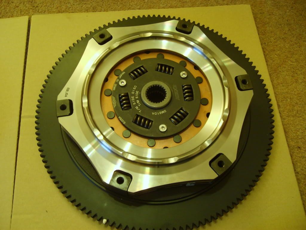

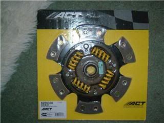

6 puck...
3 puck...
6 puck, 3 puck. ooooooooo those pics are porn. :rofl:
ah but, not as explicit as this one!!!...
:D

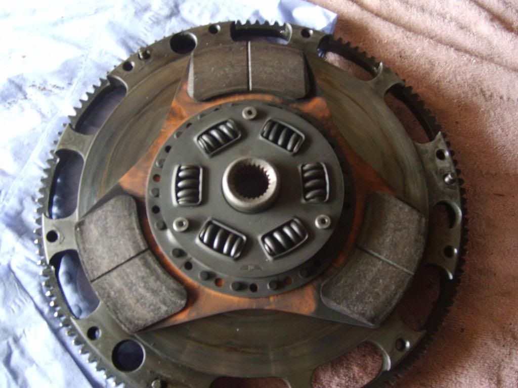

I have this just sitting around at home.
What do you think?
Membership No 0780
INSURANCE GOOFA
that looks ok to me with plent of meat on it, i would have said without looking up the figures it will hold around the 400bhp mark which is typical of 6 puck clutches
Im not too sure exactly which one it is.. Its out of one of Kirbz's old cars.
