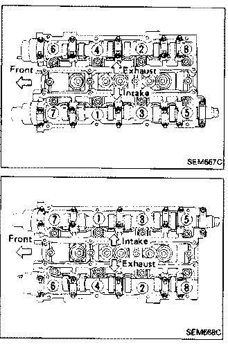

So I just do 1/4 turn on all bolts in any order and repeat the process in the same order, 1/4 turn until there all undone?

alloy heads should not just be undone as this can warp them.You should undo them starting from the outside and work inwards the opposite of when you tighten them.
Completely agree, they are tightened and released in the same pattern which is roughly criss cross, get the online service manual and print off some pages :)
I take it you will be checking the heads with a flat edge and most prob gonna skim them so dont worry to much when pulling the bolts out .The engine is out so its cold dead and as long as you get them all undone in one hit there wont be any warping however you undo them.
Thanks Jimmer.
Ok, that's why I'm checking. I thought they were alloy heads, just weren't sure if there was any specific order for undoing.
So if I do 1/4 turn following this diagram going in reverse order 8,7,6 etc?
