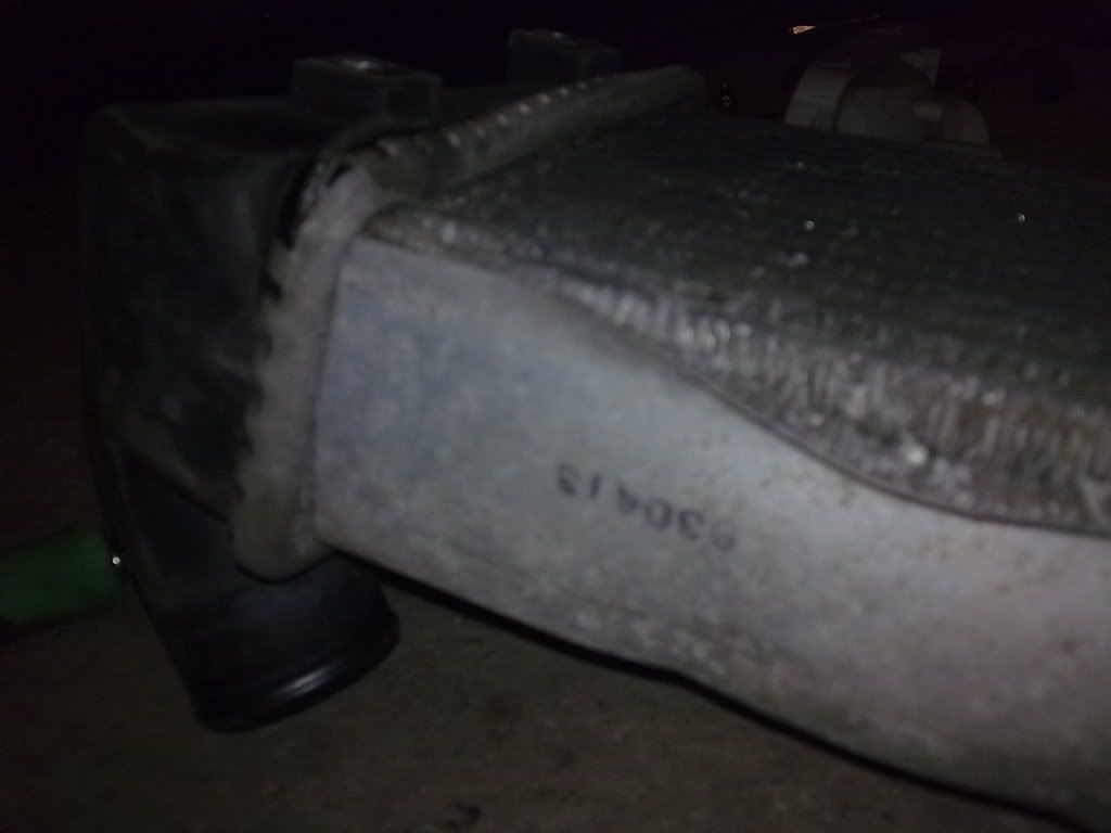

Boost leak was driver side turbo right as the rubber tubing connects to the turbo a real pitta to get to.

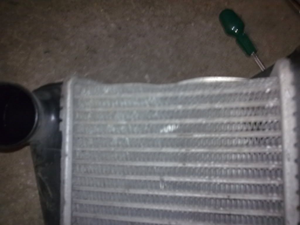

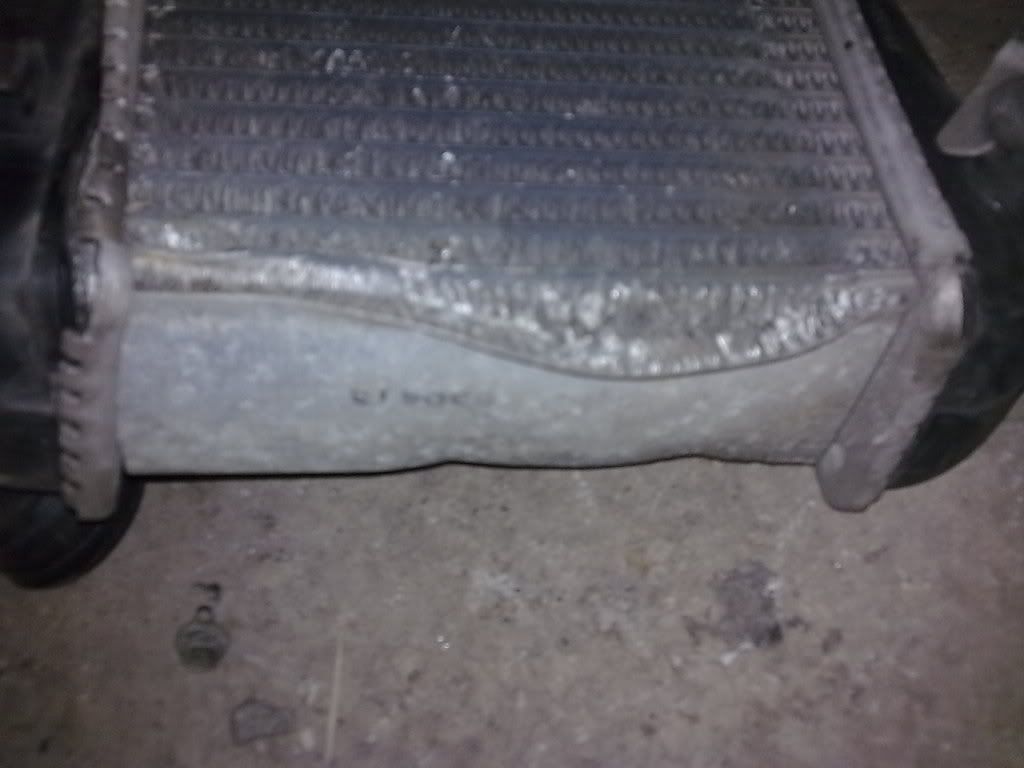

The symptoms were hearing air coming out of the car while driving it, 1 turbo working as the other couldn't get air and a bit of black smoke out of one of the exhuasts.
While doing a boost leak i was getting 0 air going around the system as it was all leaking out the Intercooler.

No probs, mate! Glad it works, and glad it's helped sort your problem - It must feel like a new car!! I had a look at the state of your intercooler when I was down Pauls earlier - I can certainly see why you were getting a leak!

No probS, mate! Glad it works, and glad it's helped sort your problem - It must feel like a new car!! I had a look at the state of your intercooler when I was down Pauls earlier - I can certainly see why you were getting a leak!

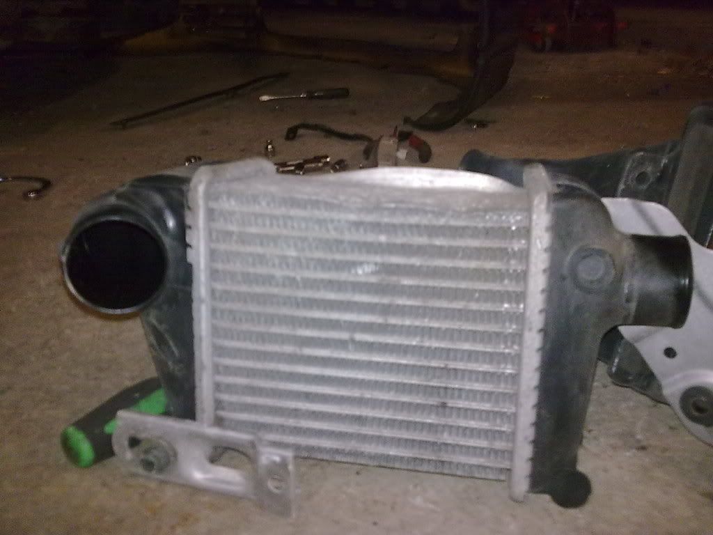

i can see the prob straight away, that part on your garage floor is supposed to be fitted to ya car lol
