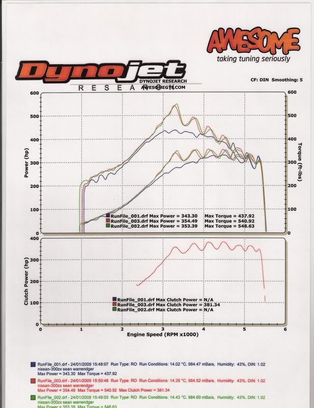

Also the good boost / bad boost you mentioned reminded me of a recent dyno chart !!.
Is it possible the thermostat could give this read out on the dyno ?
