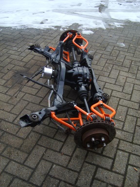

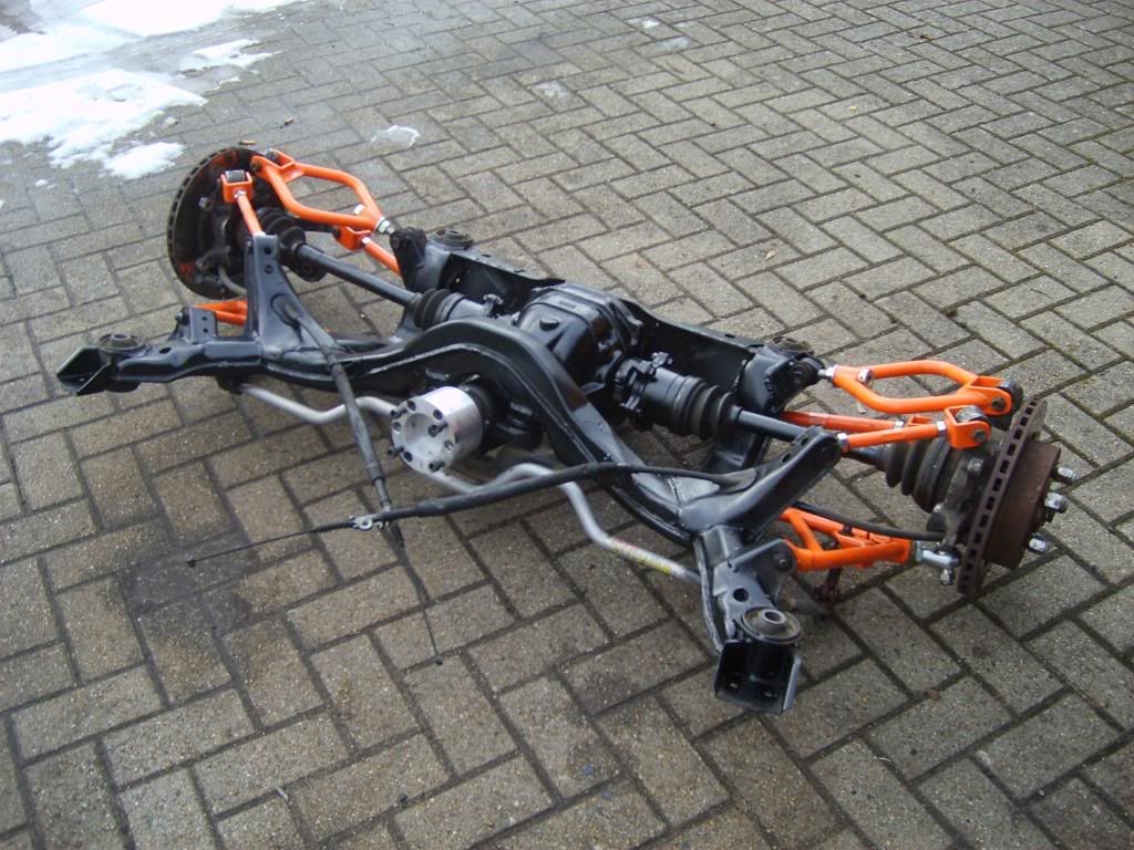

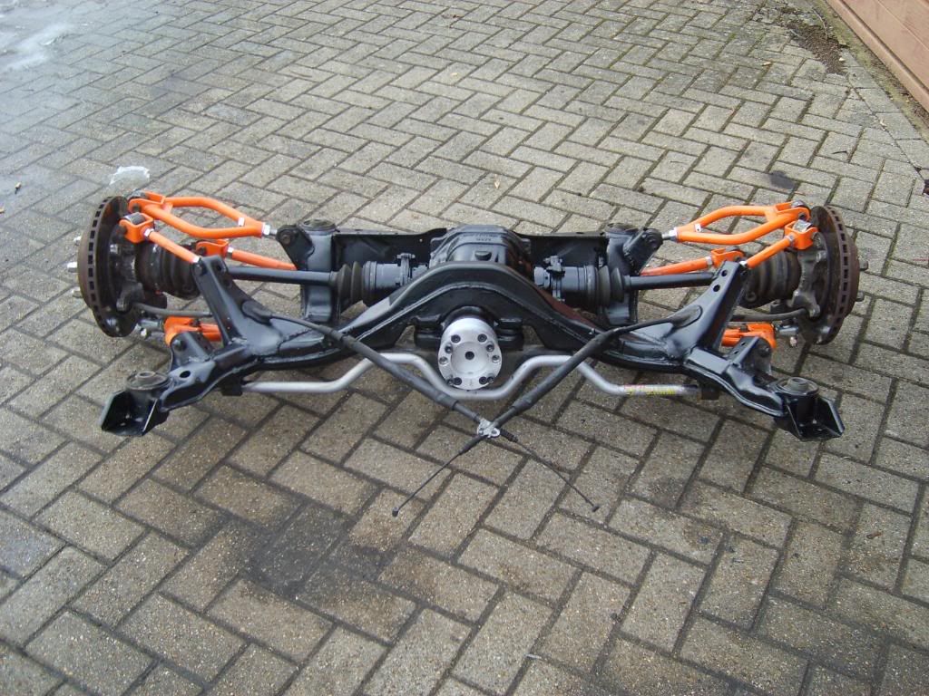

all in, it cost me £720, that was for the stock frame and running gear, suspension arms and a lump of ally for the prop spacer

Subframe looks the nuts!!!
