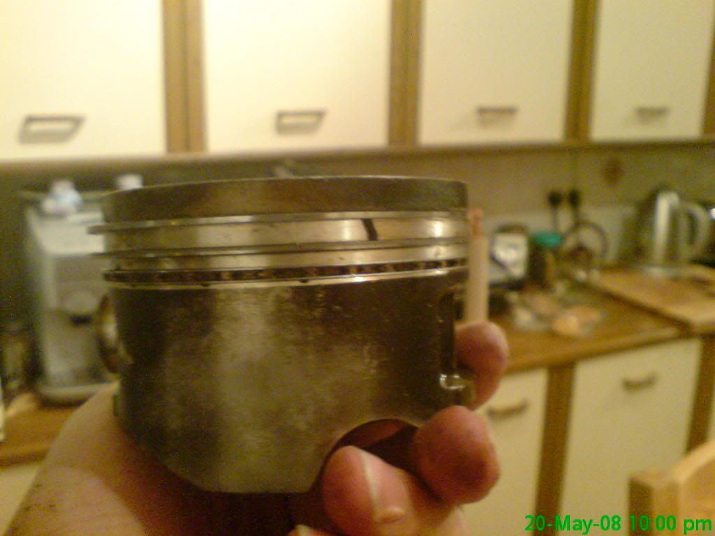

One for jeff....
What caused this lol
Major overheat?
Jeff TT
Major overheat?
Jeff TT
Duno thats why im asking you lol. Think I had a Major detonation problem at some point.
