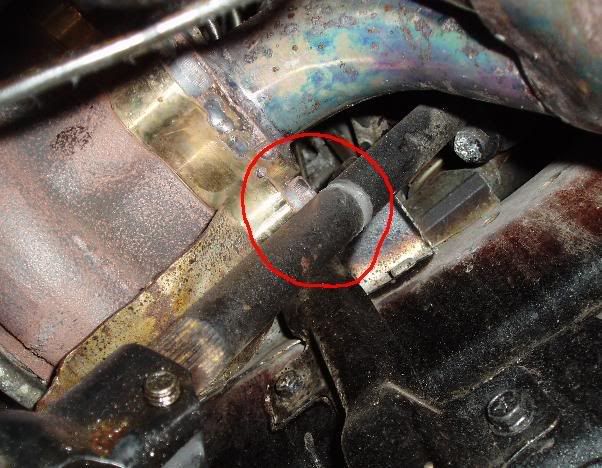

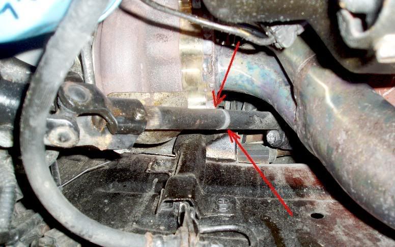

Mixed up vacuum pipes, loose pipes, missing pipes.

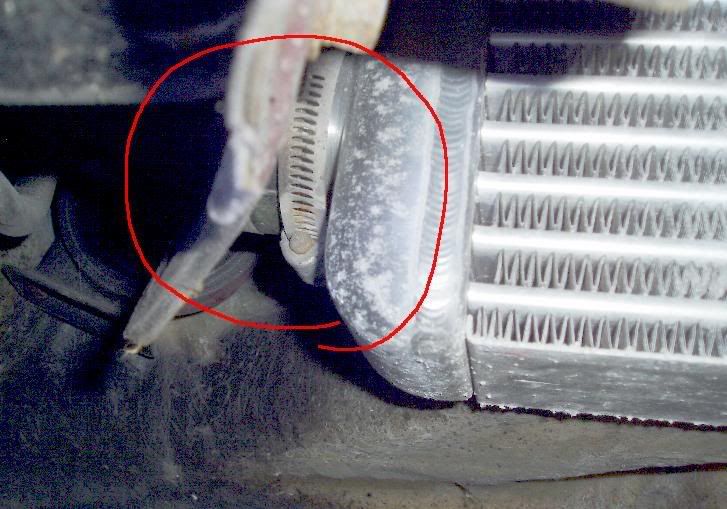

Boost leaks due to intercooler pipe clips not tightened

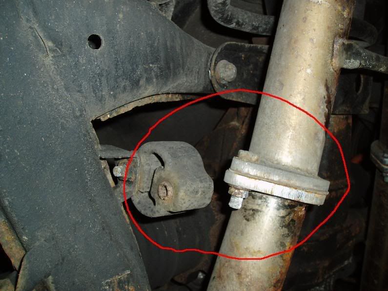

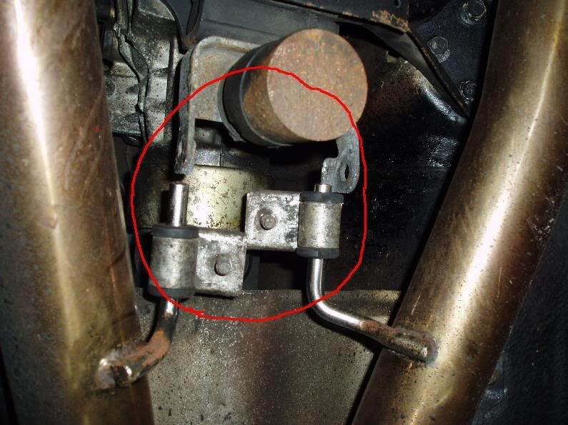

Banging exhausts due to missing brackets
Bumper fog lights not working due to NOT been connected

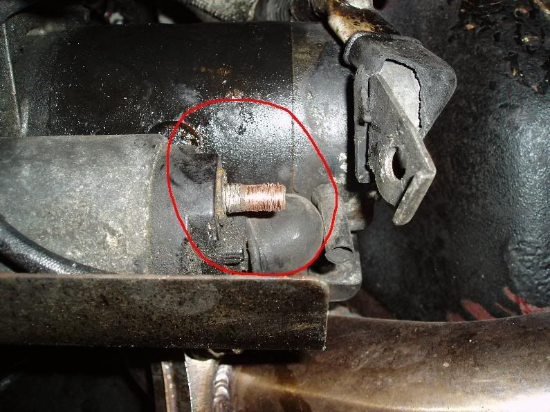

Non starter due to bodged starter motor connection

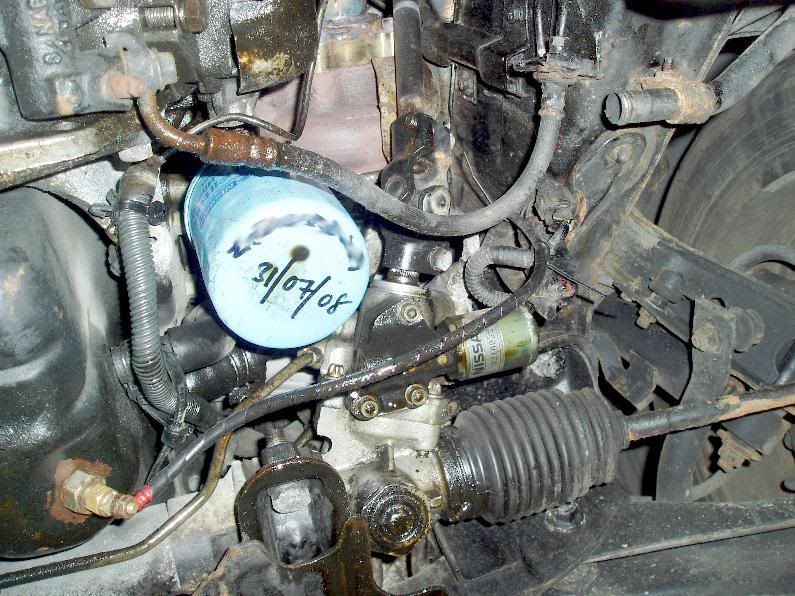

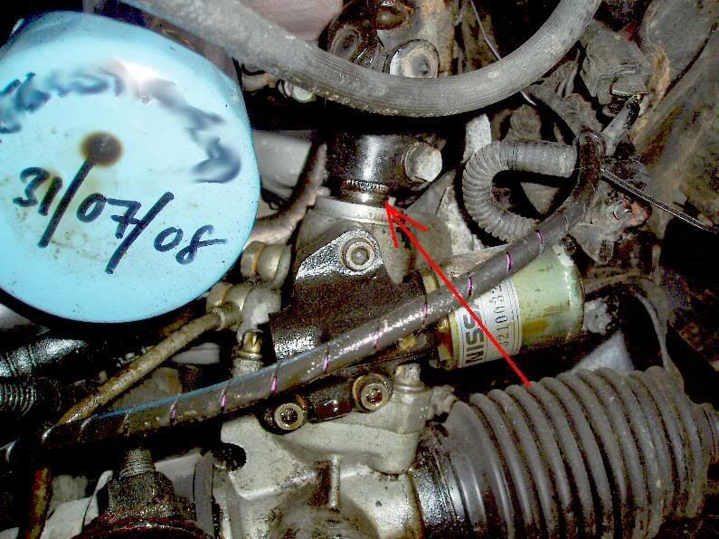

Worse of all from a safety point of view, hard and notchy steering due to turbo bolt fouling the steering shaft, in fact wearing in to it.
So would you expect more, how about after the engine was removed, the turbos then changed for monster units, how about an oil change? the date on the filter proved other wise, it seems the oil was not even changed.

The owner collected the car as the garage was closing and so took the car, went back as soon as he felt the steering not right, they looked and said (correctly ) the turbo bolt was catching but not to worry it would wear down and be ok :shock:

Problem was the bolt was high tensile steel and the steering shaft is not, work out what is going to wear out.
Jeff TT
Jeff TT

it only took me ten mins to sort it out so you would of thought that they could do it considering he got a bill for over £7000
