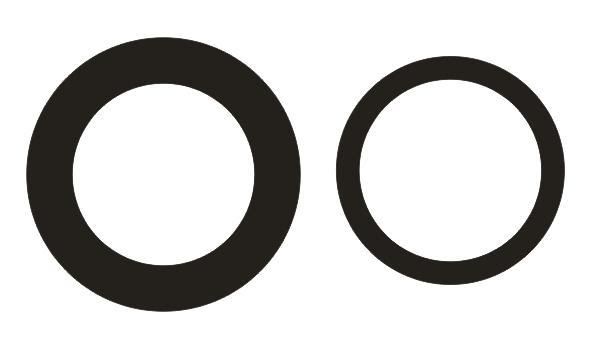

but what dimension of the tyre is that exactly? If it were the tyre walls either side of the wheel added together then that would seem to fit, making the distance between the outer edge of the rim and the outer edge of the tyre 53mm(ish).
thats what i would say it is. tbh i thought the 45 was the side wall in mm so i thought mine were 45 mm high?! doubling that would be 90 mm so i wasnt far out LOL
so its the side wall x2 which is 45% of 255. is that correct, tyres hasve always confused me. so do offset messurments
with your 265/35/18 rear wheels its doing 27.1 mph per 1000rpm.
Well my speedo is bang on with GPS till about 60mph so f**k knows :tongue: all lies i tell ya lies :tongue:
no, it is the actual height of the sidewall as a percentage of the tyre width
235/45/17 sidewall height is 105.8mm (10.5cm)
Edited by Yowser
I've made a scale diagram of a 17inch wheel with a 235/45 tyre, one going on 106mm tyre wall, and the other 53mm wall:
I just popped outside and quickly measured a stock zed wheel -
245/45/16 and it came out at just over 10cm on my crappy kids 15cm ruler.
btw 235/45/17 is the wrong tyre profile for a Zed, it should be 235/40/17
