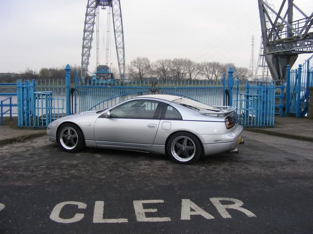

the entire car including engine bay looks from the picture to be stock with the exception of (the wheels and) the 2 vents on the bottom of the front bumper (it came with vents just not those ones) suggests possible uprated intercoolers. but nothing that obviously indicates it might do 400bhp
[sIGPIC][/sIGPIC]
What I would say is the front bumber is not the original from that car so most likely had a smash at some point, as that is an N/A bumper with a couple of air ducts badly put in for the intercoolers
Also looks like its had a full blow over respray looking at the engine bay, that along with the front bumper would make me question its history.
Hard to tell from pics, but does look it.

also the car has an impul front bumper, nice lookin motor
sctually, not sure if it is an impul think its just standard with ducts cut out, which may suggest bigger intercoolers???

Nice set of wheels on her. What are they?
Work equip 3 piece splits. Just had them re-furbed. TBH they are one of my favourite things on the car. you can see them on a couple of the cars in the "best looking zed" thread. I was really lucky they were on her when i bought. Bit tatty but lovely now they are done
Really, really like them :bow:
Thank you
