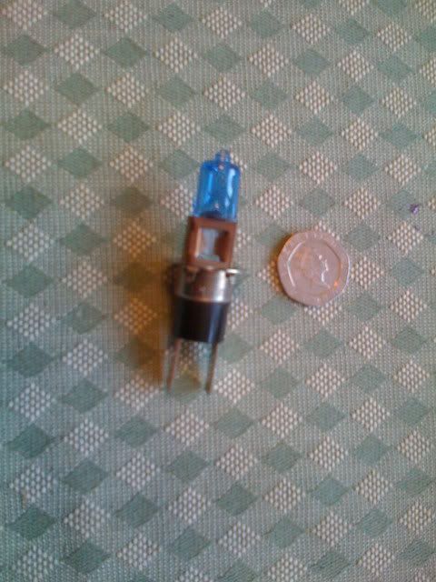

Could someone please tell me what the below bulb part no is? I need to order one as its blown and Halfrauds were no help whatsoever.
Cheers
Mike
oh yeh sorry its a headlight bulb (sidelight)
That is a Jap bulb from the dip beam 55w. you can get then from the ZCentre or do the single pin conversion and use UK lamps think its H3, will have to look it up.

had to look up bulb type
The conversion consist of making your own ground wire and screwing it into the headlight housing ( a little screw near the retaining clip).
Its really easy to do and allows you to then use the H3 bulbs which are readily available in the uk
