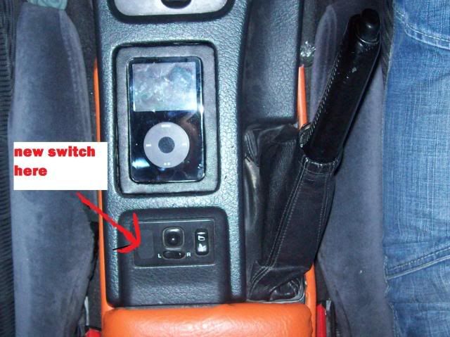

as some of you know i got my finger out and finished my ipod holder, as it sits the now you push one end in so you can get it out from the other but what im thinking is getting on old electric wing mirror and a set of the switchs for it, strip the old mirror down and remove the motor from it that makes it fold in and use this to move a plate under the ipod so that it pushes it up for me, to control it id take the switch out of the controls that would normally fold the mirrors in fit it into the spare space on my existing controls like in the pic below thus being able to press it to lift it up ect. what do you think worth it? will it work? or just leave it lol
great idea, but unfortunately the switch block is a sealed unit, although its moulded, i suppose you could hack one apart to try to modify it.

If you got a electric mirror unit, unsolder the plug inputs and push out three hollow shafts the top cover which holds down the two motors/gear box, cut the cover in two and trim unwanted off, now remove one of the white toothed rack with a small ball joint on the end, drill a small hole in the end for a rod/wire about 1mm, now place the motor/gear box and toothed rack together and a bit of tap the holed, now you have a small actuator, or you could use a boot release from a Ford fiesta which are one way movement with a spring return sum are up down and sum push up depending on year.
I hope this would give you some idea on a low cost approach …!

still need to get a small lifting actuator only want it to lift about twenty mil so i can get it back out easier any ideas on where you get them
