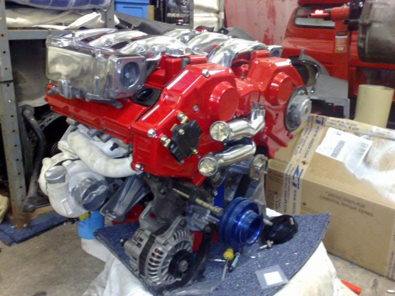

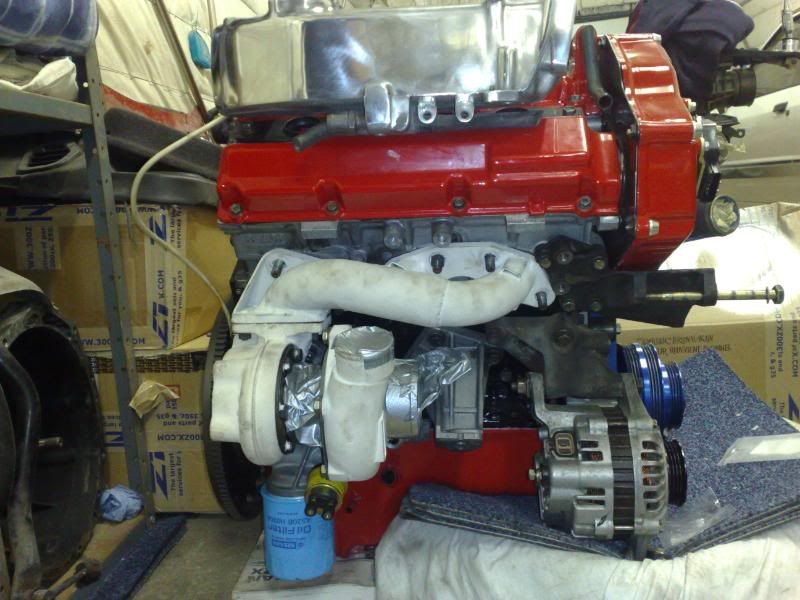

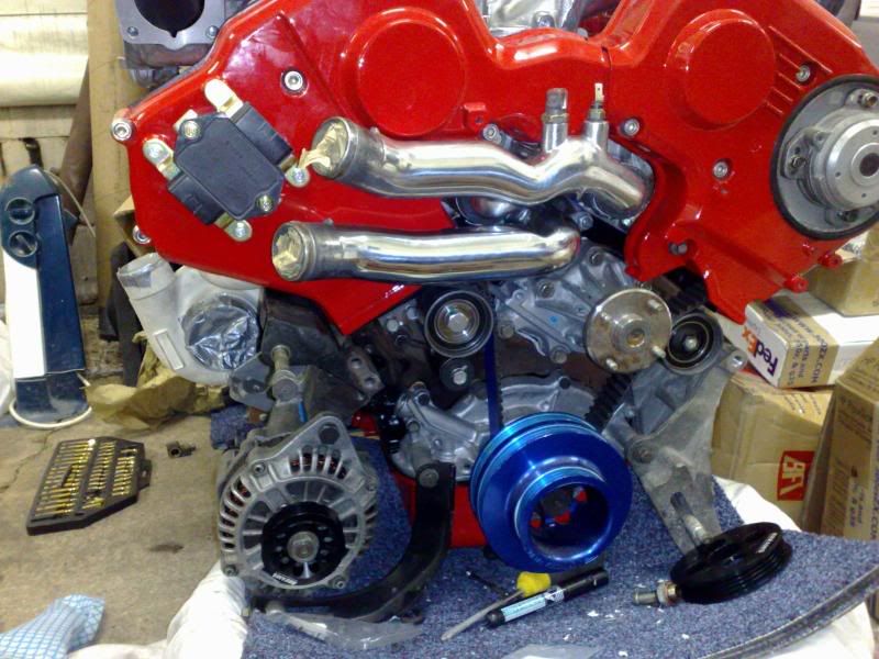

Im having trouble fitting the tubs on my nearly complete engine.
Its really pi$$ing me off and have given up with the project at the moment.
I have GT28rs with Greg dupree manifolds and HKS actuators
Here is a few pics any ideas are welcome:bow:

on mine, we had to modify the oil filter housing to make space. Will ask for the full details.
Nice setup by the way ;)
Yea im seem to have the same problem with my oil filter housing aswell.
Any details would be great :dance:
Cheers hopefully ill get it up and running soon;)
Worst case you should be able to make up a take-off plate to re-locate the oil filter remotely and loose the housing. It only needs to be big enough to get 2 -10 fittings onto.
Should free up a fair bit of space.
