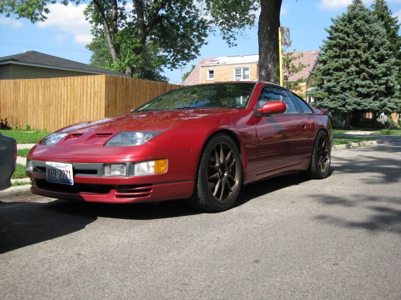

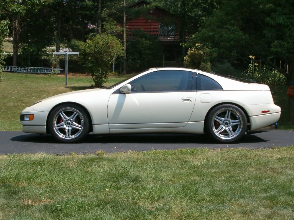

18's anyone got any pics of a 40mm drop on 18's? also whats the deal with the 45 quid ones on ebay? bit dodgy?
Yes, dodgy Chinese springs.
This is lowered around -35mm to -40mm. Megan springs.
