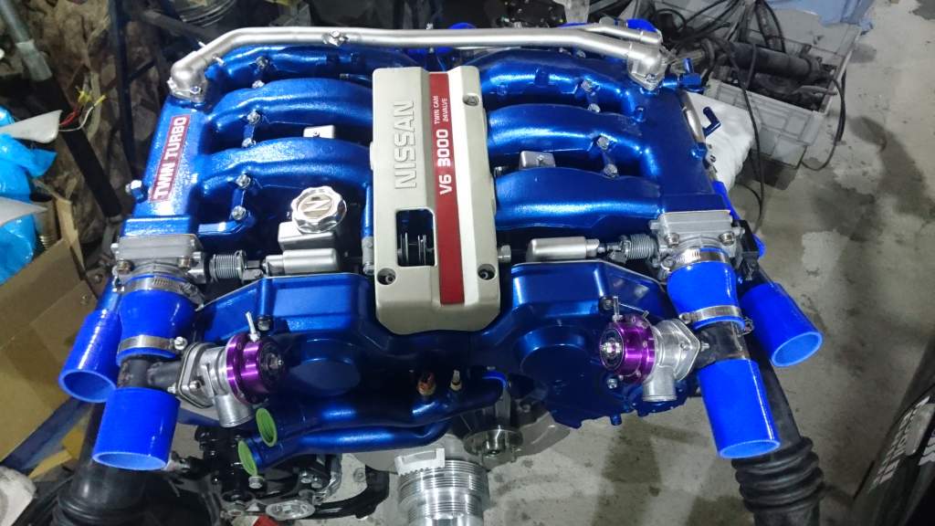

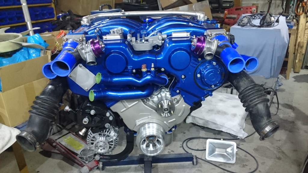

  12. Engine and transmisson soon ready to mount:clap::clap::clap:
  13. Thx a lot all. Don't have a lift. So i will take a change to get it in together.
