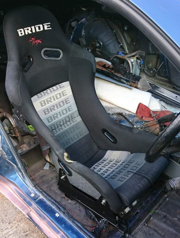

  1. I know bride make them, I just wanted to see if I could make one myself
  2. Hi everyone, I've been looking for a aftermarket seat rail for my Zed so I could install my bride seat. With no luck I've finally decided to have a go a making my own rail up. So what I did was unbolted the original electric rail for the standard seat retaining all the motor and electrics and I brought a pair of aftermarket side mount brackets. So I lined up the new side mounts to the original rail, the rear bolts lined up perfectly and I just needed to make the front holes a little bigger and cut off and remount the seat belt buckle so the bolt holes all lined up perfectly. so I loosely fitted the rails together then bolted the side mounts to the seat once the side mounts where bolted up tight I tighten the bolts up to the rail and mounts and the seat and rails bolted straight in the car and all the electrical work I just need to make a little mount up for the switches.
