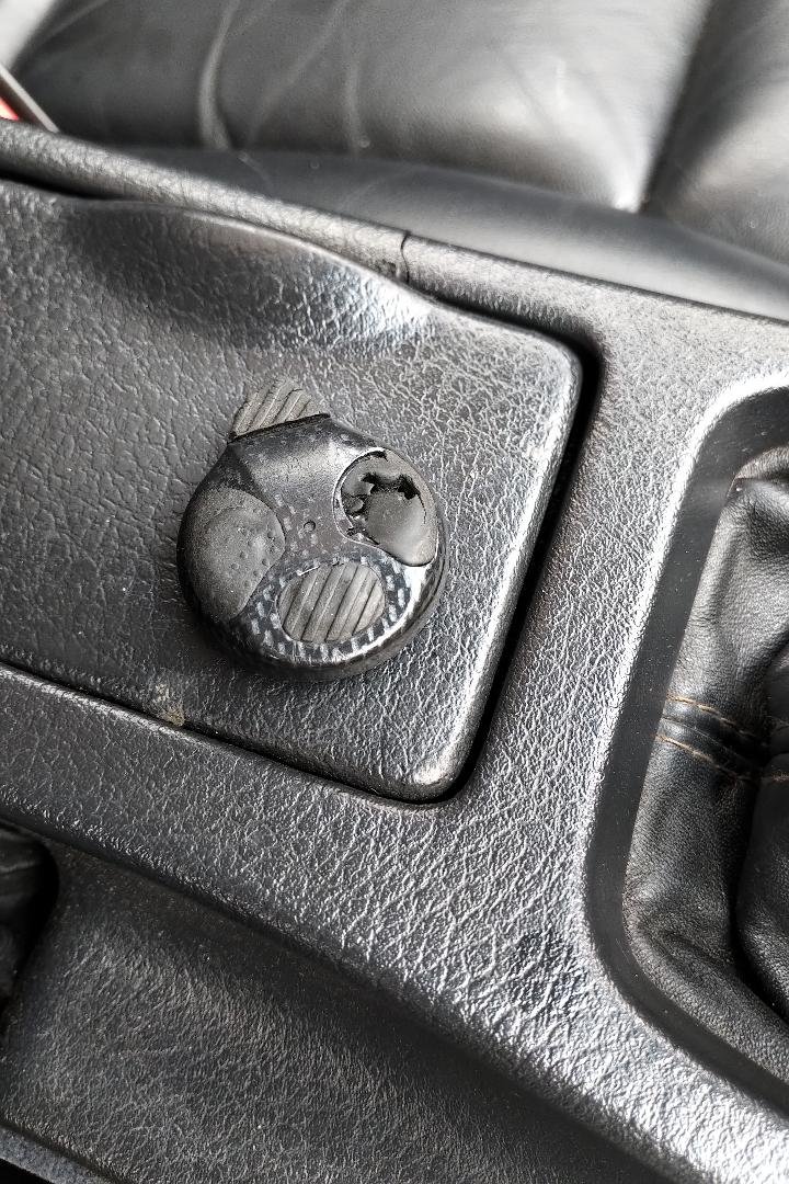

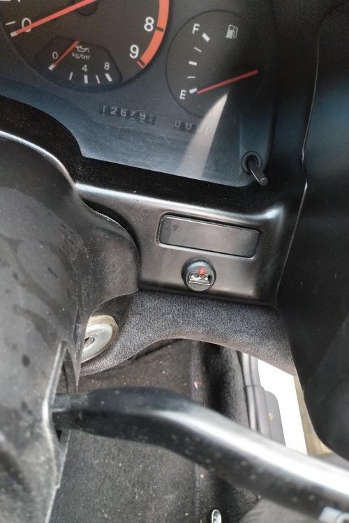

  1. thanks for the info, in the end I had the whole thing removed, more trouble than it was worth, car now starts on the button
  2. So I have this stupid aftermarket alarm/immobiliser system on my Z, had it when I bought it I attempted to start car after sitting for a bit and primed the ignition with the button on the fob as usual, lights came on dash as normal and car failed to start due to low battery, so I removed battery and charged up in house put battery back on and went to start car, turned key and pressed button on fob to "prime" ignition, usually you wait about 5 seconds and all the dash lights up and start car, however now nothing happens so I presume something has triggered the alarm to immobilise the ignition this has never happened before in my history of ownership (since 2016) and I have had dead battery's / had to jumpstart / removed battery before etc no idea what make it is, see pics of fob and the light/keyhole The alarm still locks and unlocks the doors with the key in the off position in ignition barrel so its all working I have checked ignition related fuses relays etc all are fine Anyone got experience with this sort of problem? car is a dead duck on my drive now
