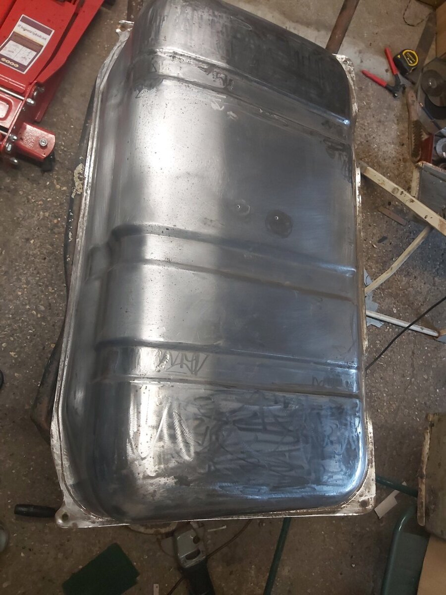

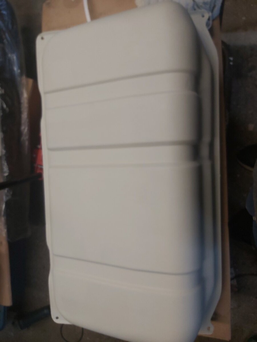

  1. It's not difficult it just takes a bit of time you got the 2 fuel lines to remove the tank an fuel neck have 1 pipe each 1 electrical connector the fuel neck as a cover that as to be removed I undone the 2 retaining straps bolts closest to the bumper my bumper was removed I'm not 100% sure if the bumper as to be removed to get to the bolts
  2. Thanks yes got the tank out I undone the straps nearest to the bumper I just wasn't sure about if the straps could be completely removed. tank strip and primer just top coat to do

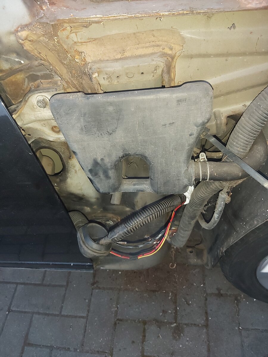

  3. Thanks I get right under the car an have a good look when I took the heat tray off it looked close to the subframe

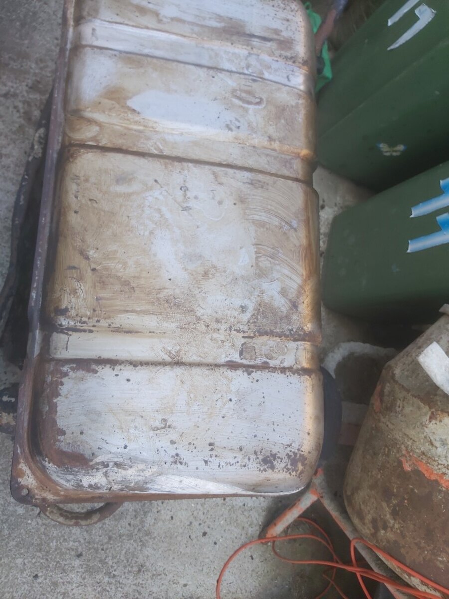

  4. Hi can the fuel tank retaining straps be completely removed with the sub frame in place as why I've got the tank off I was going to clean them up an paint them thanks
