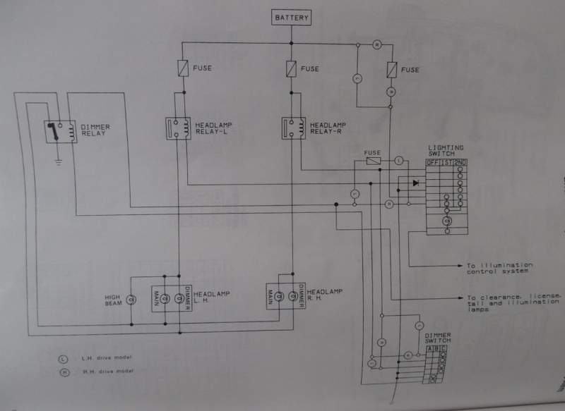

  12. Checked that fuse its fine All other bulbs are fine its just the dipped and full beams, as the full beams are getting half the voltage each whilst on dipped beam should tell me something but I can't think what. I'm working off this diagram
  13. Ah just found a relay drivers side wheel arch, quite corroded. Nope, cleaned it up and it works nothing changed
  14. Can't seem to see a relay behind the passenger side wheel arch. Seems to me that the high beams are somehow at the moment connected in series sharing 6v each whilst on dipped beam. When high beam is enabled the passenger full beam gets the full 12v. The diagram shows 4 fuses relating to the lighting system, I can find 3, 2 in next to the relays and one drivers side footwear. The h/lamp dim relay is exactly the same type of single pole relay as the h/lamp rh relay but the h/lamp lh relay is of a double pole type, is this right?
  15. I'm just going to dump my continuity findings here as I go along. Testing between the light connectors and the relay board. Drivers side Green/blue driver dipped to LH relay Continuity Red/green driver dipped to LH relay Continuity Red/green to red/black Continuity Red/green to black/silver dot Continuity Red/green to white/black Continuity Red/green to solid black Continuity Red/green to purple Continuity Green/blue only has continuity between green/blue Red/green is earth? Passenger side Red/black has continuity with the following Solid black Purple White/black Red/black Red/green Red/black is earth? Solid red passenger side only has continuity with solid red Passenger full beam connector continuity test between the two connector pins. Red/black + white/black NO CONTINUITY Drivers side full beam connector plug pins Red/green + white/black HAS CONTINUITY Rh relay pins 1+2 there is no 12v problem could lie here...
