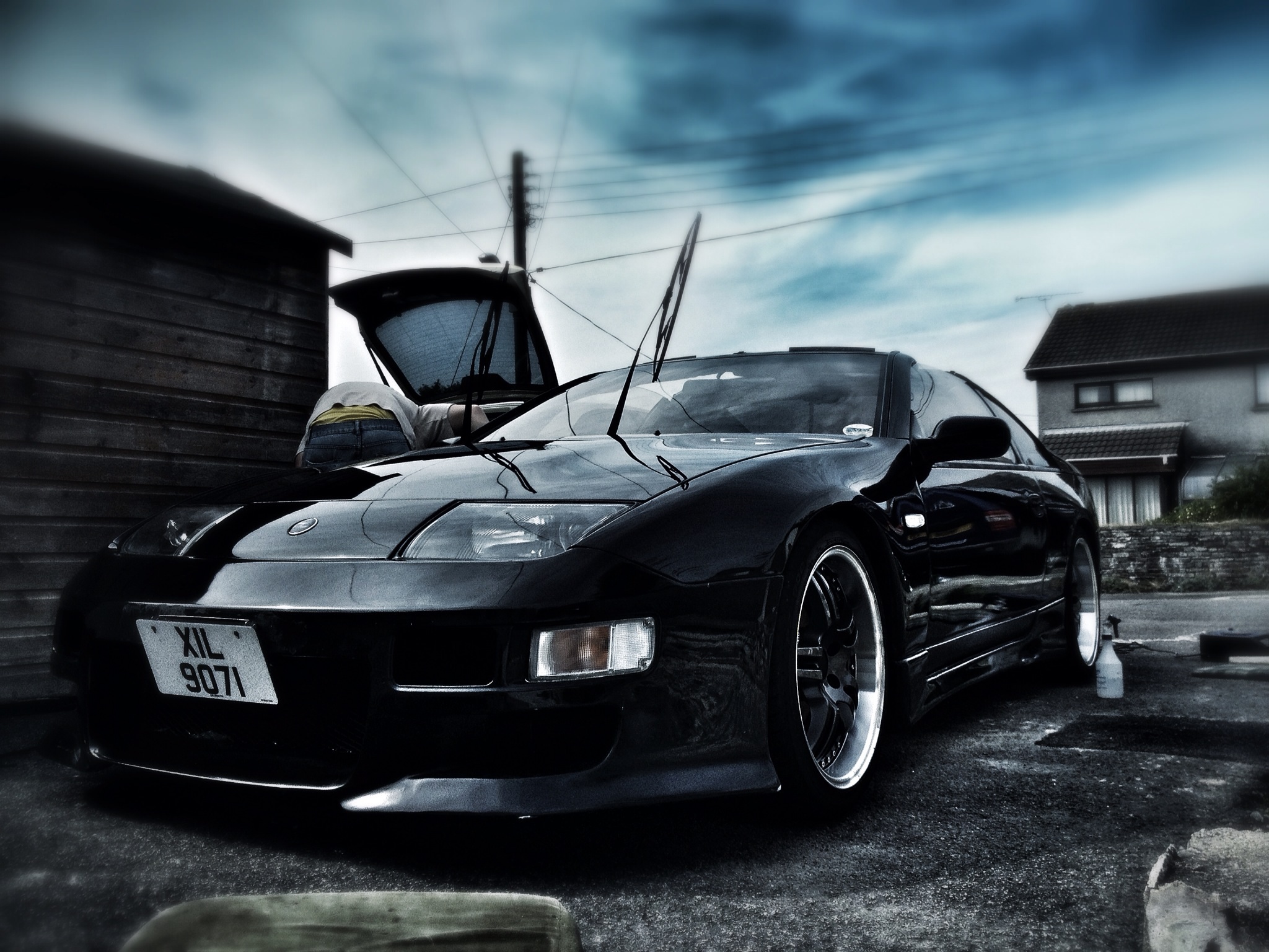

  6. Update on 300zx Tidy Up Ongoing work further investigation into water ingress is that i have a small amount of welding on the passenger floor but none on the drivers side :). to be done this week. all tweed interior trim has been removed for retrimming in suede, (waiting on material to be delivered) headlights have been removed cleaned and seals have be treated and cared to look like new :) when hid replacement lamps arrive will be fitting them all back together. bumper had been removed ready for a nice black hex grill to be fitted. bumper signal lights have been removed cleaned and sidelights drilled into the blanks for LED sidelight lamps to go in. all front suspension has been cleaned and treated inc arch cards. whilst wheels were off. engine bay has had a clean and tidy. Left to do: refit all interior once pieces have been re trimmed. refit front bumper when grille and hid lamps arrive rear suspension clean matte black spray or wrap ( not sure yet) down each side and bumpers of zed leaving gloss black bonnet new number plates to be fitted. Detonation sensor resistor to be soldered into place, ( cannot proceed until bumper and lights are done to refit airflow sensor for the correct ecu diagnostics readout ) when testing the new resistor being fitted. trying to get as much of the tatty bits tidied up but is a pain waiting for things to be delivered online :/ more updates when parts arrive and get fitted, will also try and get some pics Marlow TT Cornwall

  13. Thank you yes I will look into the bypass of det sensor although be good to get it done properly, does anyone know where the det sensor runs in the loom and from where? Nd yea brakes are stadard calipers gonna strip each one refurb, refit new with new braided lines and new fluid. Is £220 the cheapest you can get a t top rubber seal for? Marlow TT Cornwall
