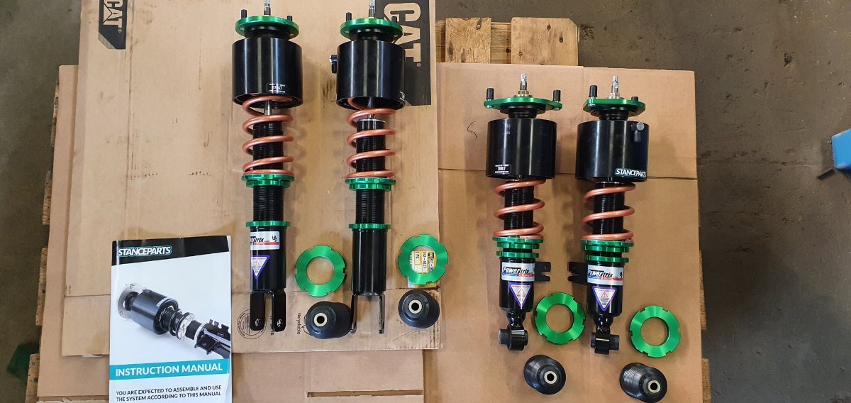

  3. This is my new suspension set up, I hope everything will fit. Powertrix coils with harder and lower Swift Springs and a stance parts air cup system that will raise the car approx. 2 inches.
