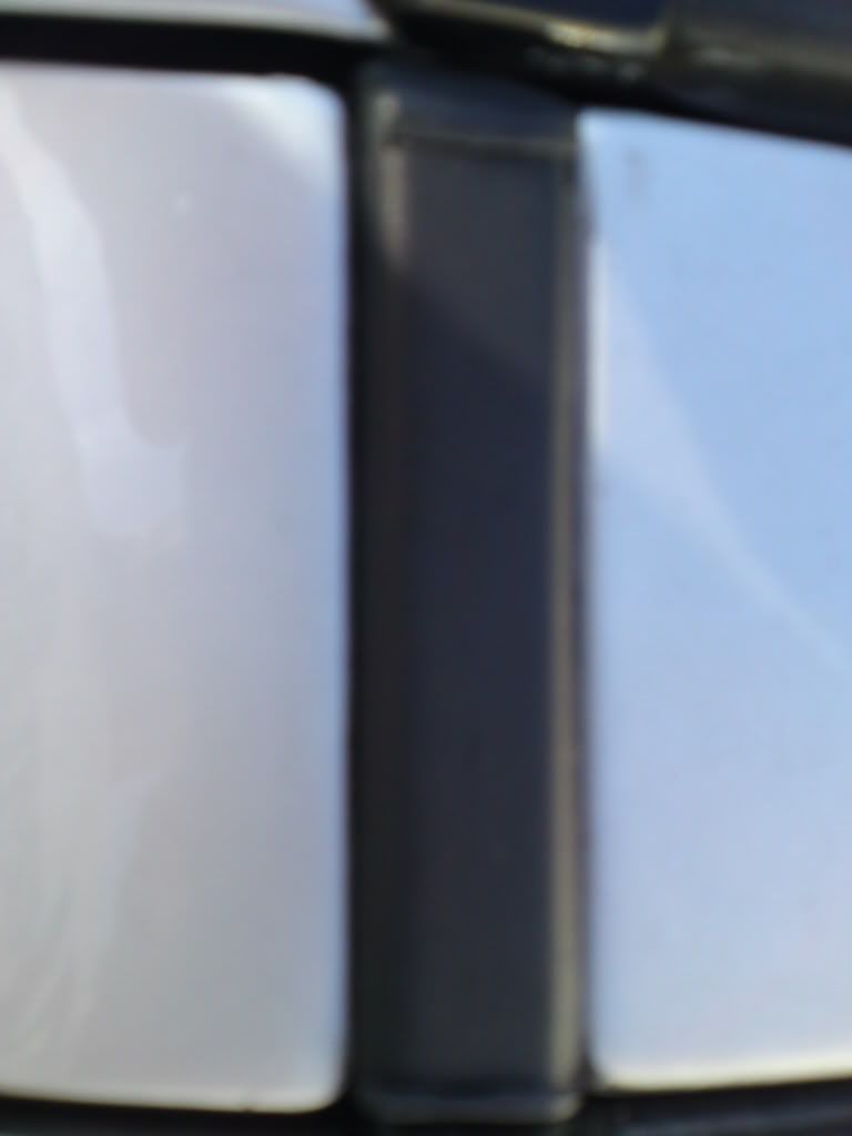

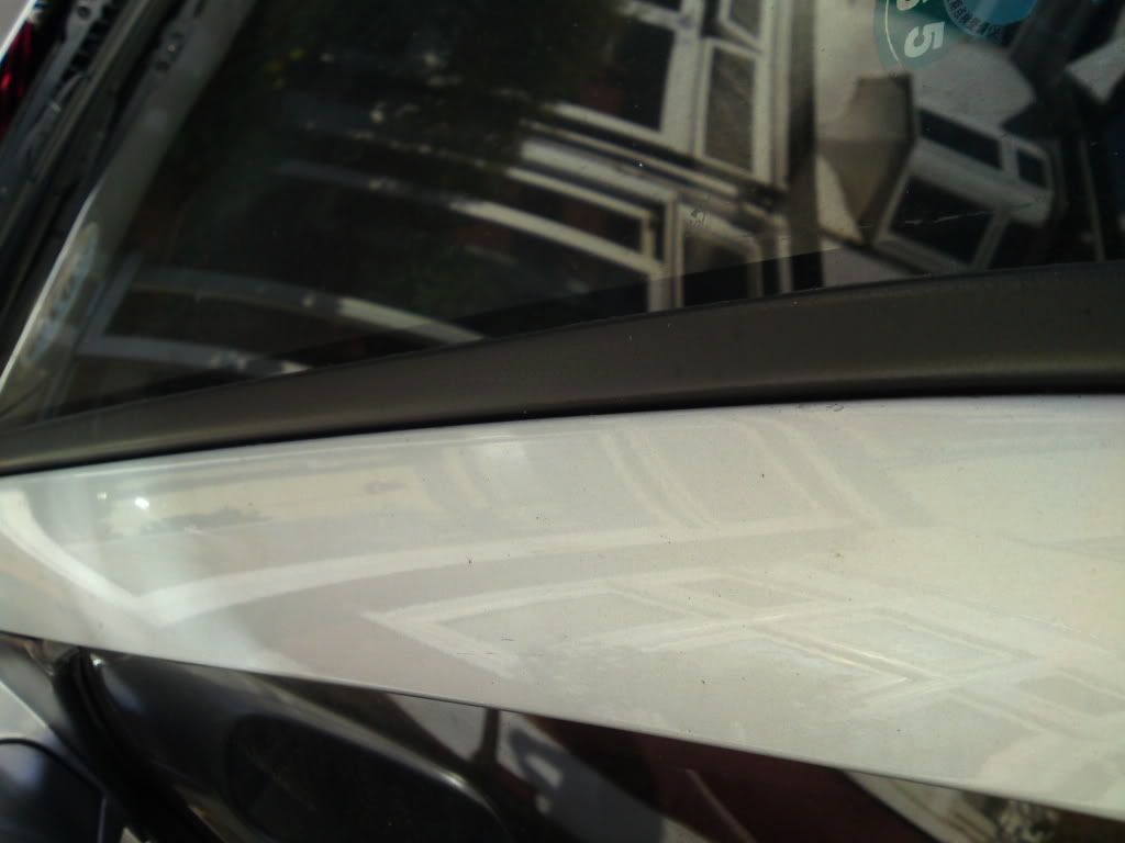

My windscreen trims somebody has scrapped most of the original coating off already but the targa trims are still black.
