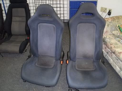

Does anyone know if Skyline GTR R33 Front seats will bolt directly into a SWB 1990 ZED?:confused:
I know they wil fit directly into a S14 200sx but not sure with a zed.

r32seats.jpg :confused:

Seats will require modification of the subframes to fit. I had to do a fair bit of work to get mine to fit, involving cutting and welding brackets to adapt runners.

those in the pics are from an R32, the R33 look a bit nicer, and some even came in cream leather, but those will be worth a small fortune :smash:
Was it alot of hard work to get your seats fitted in terms of making new frames and stuff mate?
easiest way ( if you dont mind a fair bit of weight ) is a metal plate below the seat, bolt the seat to the plate, and the same with the runners, if you are at all handy with metal work this will be a piece of urine to do :cool:
However if you want it to look good, weight less etc, it will require alot of custom fabbing, measuring and the likes ;)
