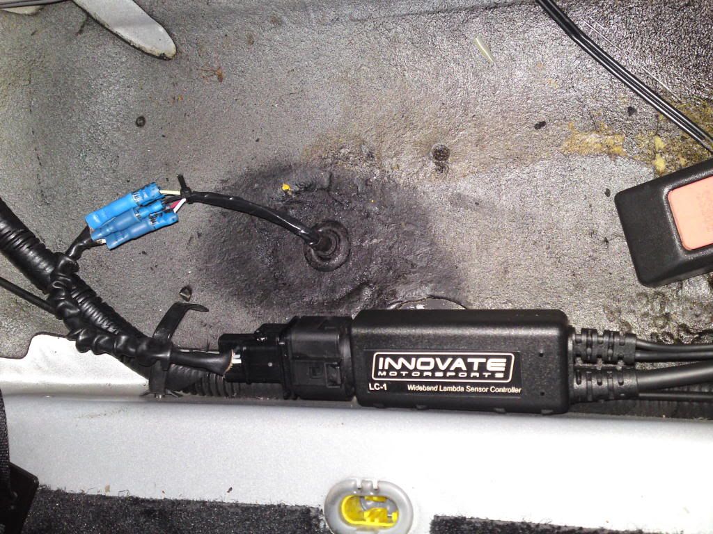

Wideband Innovate lc-1 almost up and running.
Just need to fit the last few bits.
Then i can do some data loggs and see how lean/rich i am running with a computer hooked up.

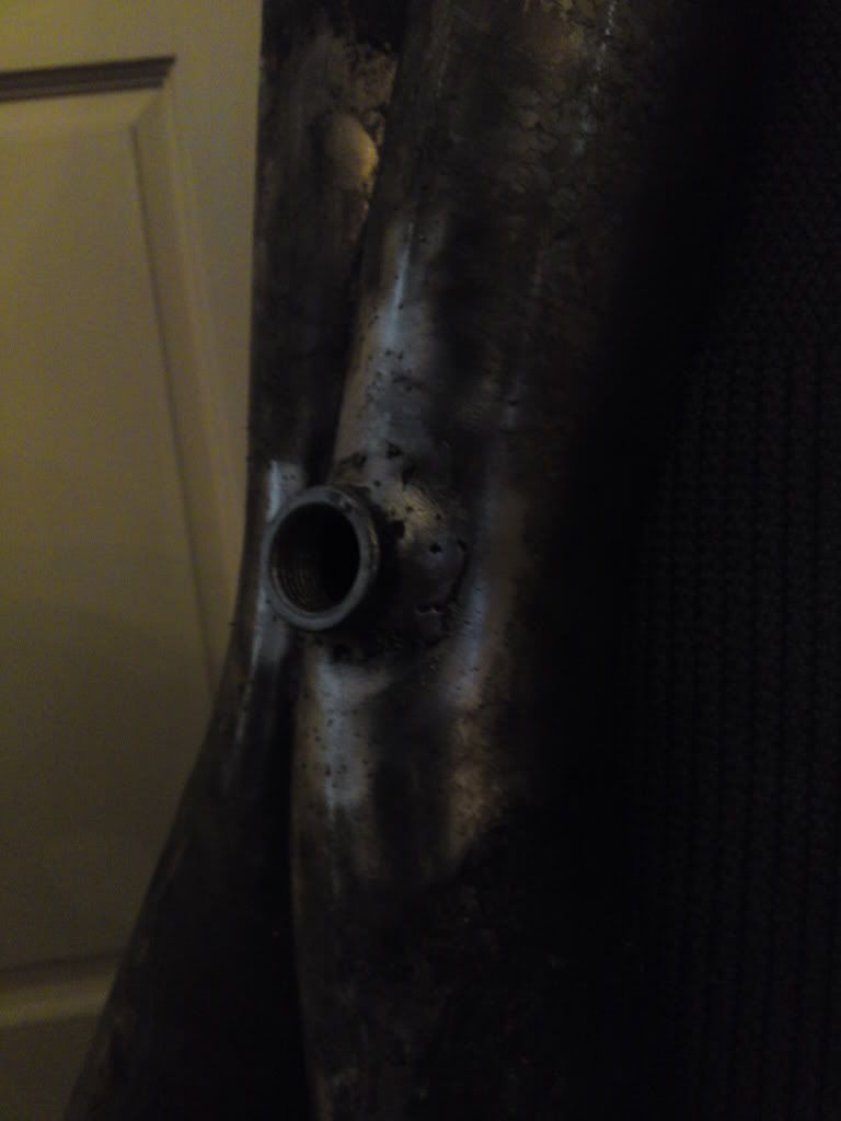

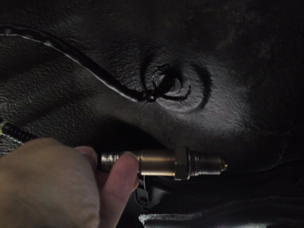

Had to drill a hole :S scary but ive sealed it up nicely and but a gromet on both ends :D
Pigeon crap welding anyone :(

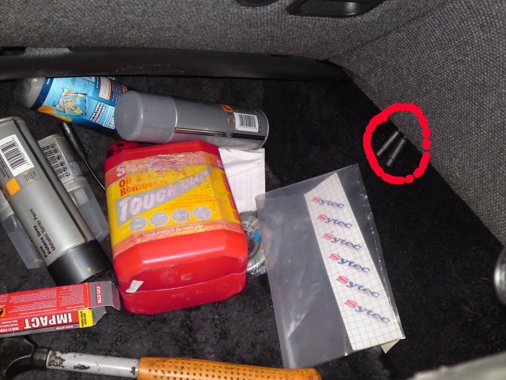

These are the wires outputs il use to hook up to the laptop.
I find a better place for them later.

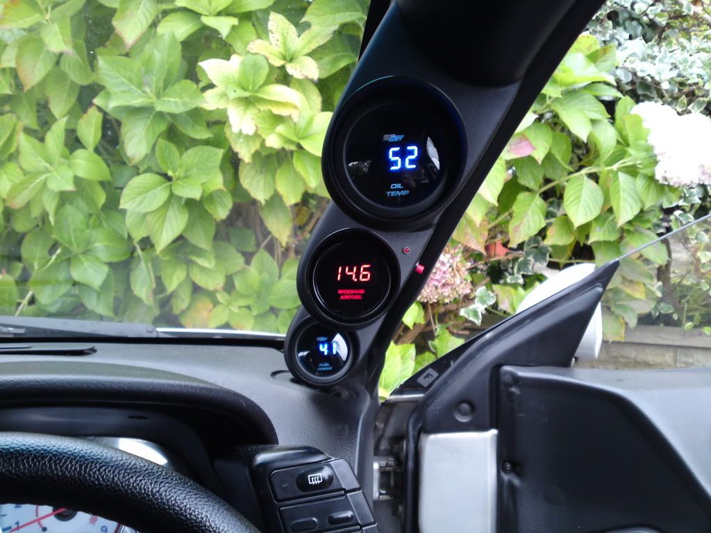

Gauge:
Edited by j1mmytt
Its done :D

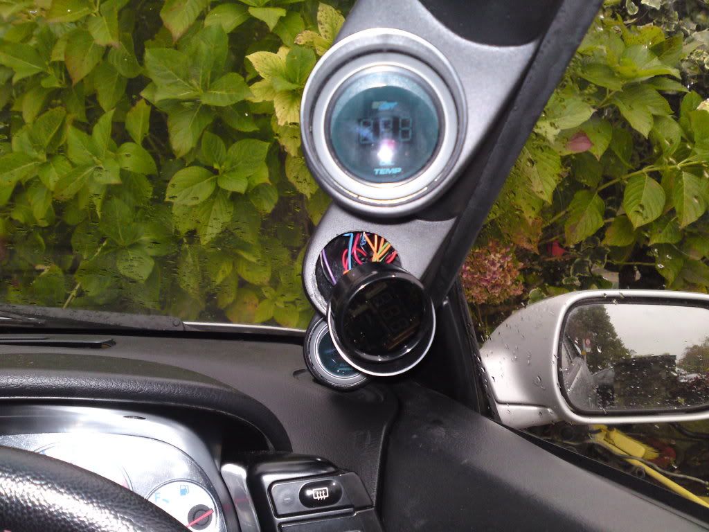

znut you were looking at something like this were you not?
The button and led is to indicate sensor warm up and if there are any problems.

Can someone tell me what the gauge should be reading?
I know 14.7 is the norm but what about when being driven?
Is it the higher the number the richer it is? or the higher the number the leaner it is?
Thanks
Thanks ^^
Thanks
The higher the number (ratio) the leaner your becoming, from uni studies (chemistry) 14.7 is the stochemetric (bad spelling) or steady state for perfect combustion. The ratio should drop as you acclerate!!
