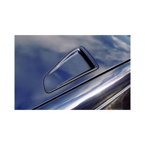

Im having a custom carbon bonnet made and would like to add a vent to realise some of the high temps from the engine bay.
Where would you think would be best to place to put a vent?
I dont want to place it over apart of the engine that water may cause problems. But in a place that the vent or vents will actually work.

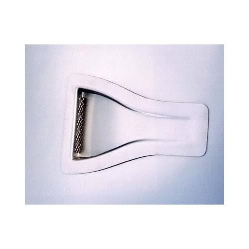

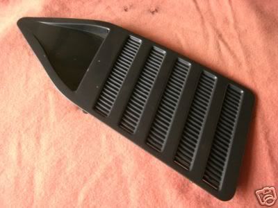

Also has any got any ideas on style of vent? I want one that will let the least amount of water in. No big scoops!
Was maybe thinking of the flat Scooby STI vent or just simple cut outs.
A few ideas I like this one off the 280z directs air aswell as a vent

I find that a small amount of water enters the engine compartment with the vent I have, the cooling benifit is very noticable.
HTH
That is what you really need is like Zoggs, but with a gutter or something to take the water away from the engine. By letting air through the engine bay, the cooling effect is quite significant. Thats got me thinking now.
