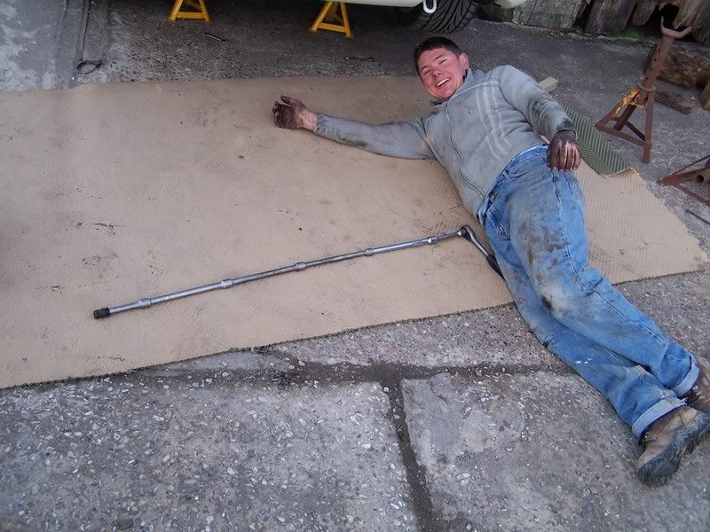

There's about 10 bolts holding the bell housing of the box to the engine, most are ok to access however the top two are not. You'll need a rachet and socket with about 4 300mm extensions on (no joke) to get to them and you'll need to loosen the engine mounts and then the top intake/intercooler hoses at the front of the engine to get the engine to rotate slightly backwards and get the gear box to hang down giving you access to these bolts.

Picture to prove the extensions needed on the bell housing bolts, lol
:rofl::rofl::rofl::rofl:
Holy Crap, Thats the biggest extension I have seen!
