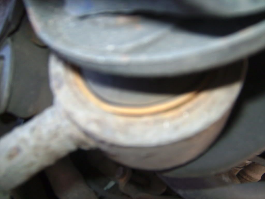

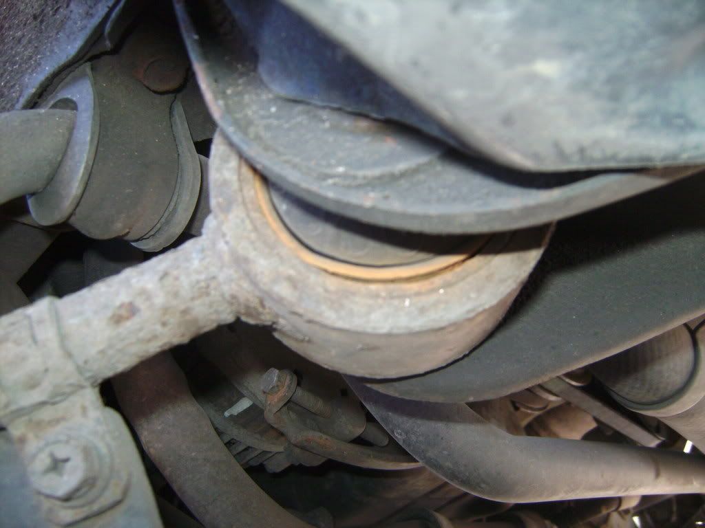

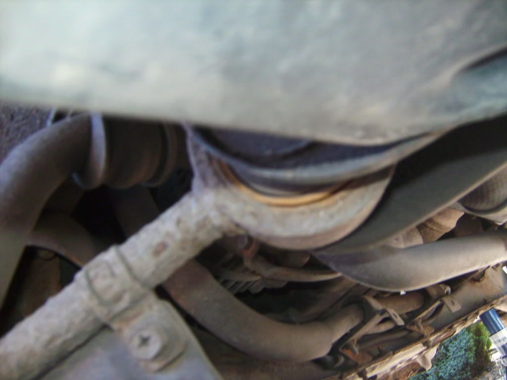

Hi I have a problem when my front wheels go over any bump in the road i get another 3 or 4 "after bumps".It feels like when go over the raised bits that tell you to slow down at a roundabout. Anyway thought it was my discs, fitted new ones and pads but no better, while i had discs off i noticed this could this be my problem looks a bit dry
most likly worn shocks have you tried pushing down on the wing a couple of times and seeing if it continues to bounce after you stop pushing
yes shocks are ok got it over a pit yesterday and found this bush was split so lookin for some new ones does any one know where i can some even the whole arms if need be
