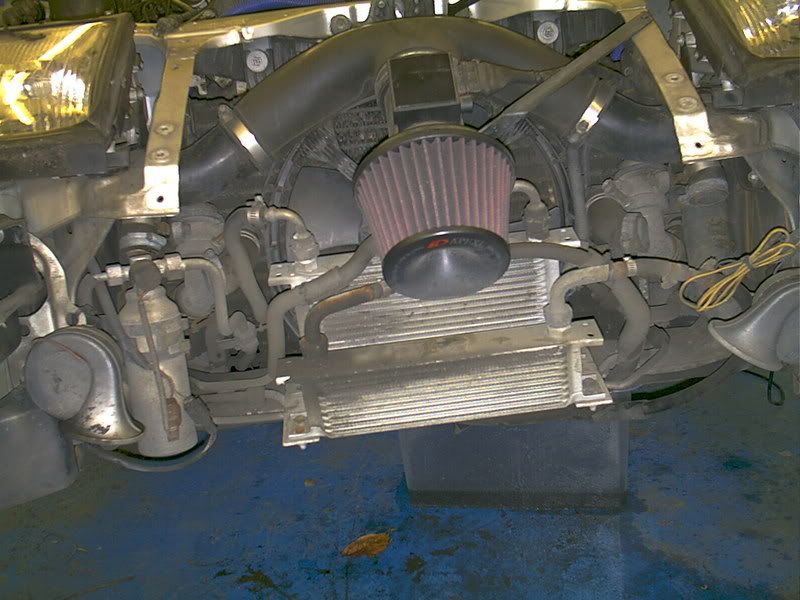

Just a word of caution with regard to the ZCentre autobox cooler. The way that setup works is you use the new larger cooler for the engine oil and use the old (smaller) engine oil cooler for the autobox. This has two inherent problems:
(1) the old engine cooler is ... er, old en prone to failure/leakage/etc
(2) cross contamination of fluids (ie you really don't want engine oil running through your autobox)
The best way forward (IMHO) is to use the new autobox cooler exclusively for the autobox. You'll need to make sure you check the fluid level after installation and top up to the mark as adding lines and a cooler increases the capacity of the A/T cooling system and you don't want to be low on oil.

I,ve got 2 Mocal coolers , one for engine and other the autobox :dance:

Hi Dan
Mine came with a superb bracket which bolts at an angle to the existing engine oil cooler mounting points, and angles the cooler so it picks up flow from main bumper intake.
Its in heavy S/S so needs no other support!
I took a card template so I can get another made up for my other Z- would be happy to take pics to make this clearer, and send you a copy of the template if it helps- at least I can vouch that it fits perfectly with a large cooler in that space!
Totally agree with your comments regarding using old engine cooler for transmission- max cooling an absolute must and explained why in the very informed advice from the scorpio owners site- same principle;
