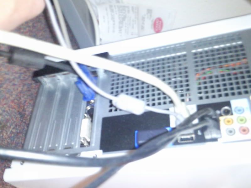

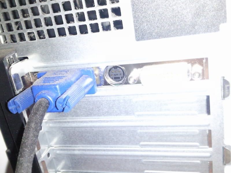

Looks like you have a basic video card, with only one analogue output.
That second socket on the graphics card looks like a DVI (yes, it's a crap quality photo LOL). Get an adapter plug and run your second screen from it.
That's exactly how I run mine.
Didn't look square enough to me, I reckoned it was what they used to call a Game port.
very rare theses days to get a game port on a G card, must be a dvi.

As above. Just use a DVI to VGA converter Plug. A lot of graphics cards come with them in the box as standard.
