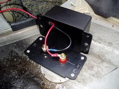

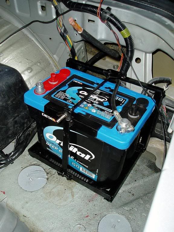

Dave, when I relocated my battery to a cage I knocked up in the boot I also put in two terminals that surfaced in the boot itself and went through the floor so they could be accessed from underneath the car (keeping them hidden was important for me just in case...!) in the event that I needed to charge her (I'd de-locked and de-handled everything on my old silver Z). Seem to remember I picked the box+terminals up from maplins for a couple of quid. It's not what you're talking about but thought I'd mention it just in case!
