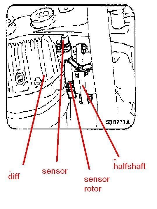

check abs signal rings for cracks/damage this is a common fault that causes problem you described.
also mate on older cars the sensor ring on the back of the wheel becomes corroded the sensor connot read it all you have to do is wire brush it hope this helps you
The sensor ring is on the halfshafts on the rear not the hub and the sensor is connected to the diff.
Oh no it isnt:nono: The sensor ring and the sensor are located on the diff.
when i say sensor rings i meant the groves on the halfshafts or just at the end of them, so yeah on the diff then, so stop being clever:tongue: , they rotate with the shaft or "diff" they are called sensor rotors so there :tongue:, the sensors, those little round things with the wires coming of them are on the diff too.
